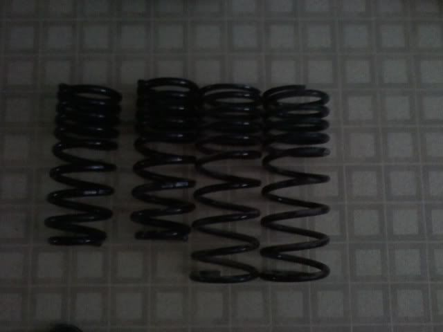

hey guys, well like i said i picked up the lowering springs at the junk yard, and they are eibach, i paid only 42 bucks for them, looks in real good condition. this is a stupid question, but on the pic does the smaller set of springs go to the front and the bigger set go to the rear? just want to make sure before i put this on.

sorry forgot to put the pics, but isnt struts with spring all in one and shocks separate even tho its the same shit? like a 88 model mustang? thats how i see it as.
