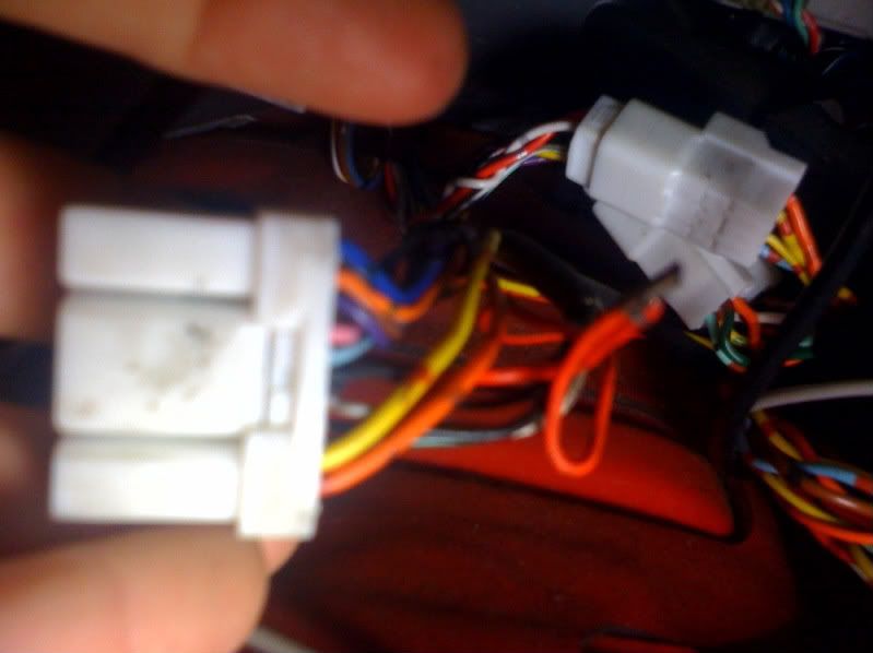

I pulled the radio out and found this red wire taped up:

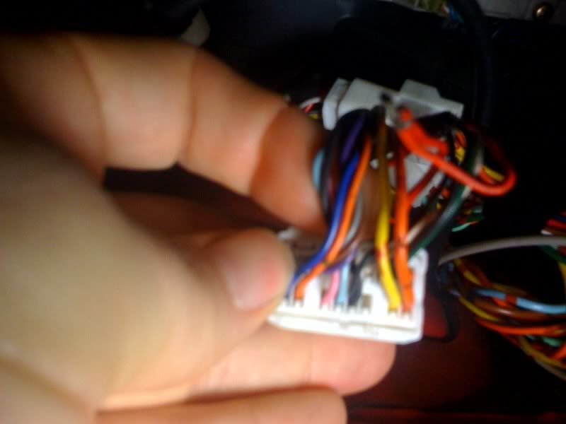

It looks like it may go into the back of the radio plug. Since to me, the top of the red wire appears to have a broken pin:
But im not real sure where it goes. Sorry for the crappy phone pic.

cant really tell what I'm looking at for that wire. probably where it was tapped into to get power to the phone device.. it should be easy to tell whats factory and whats not. remove what doesnt belong and go from there.
