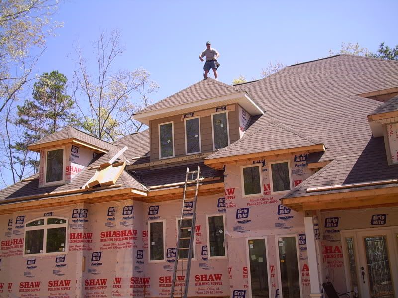

I am a trained professional with a tool belt and everything........if you have any questions feel free to send me a pm.
See......:icon_bigg
Dec 3, 2003
6,653
Canada
See......:icon_bigg
A trained Pro at what? Not knowing anything about safety? :biglaugh:
