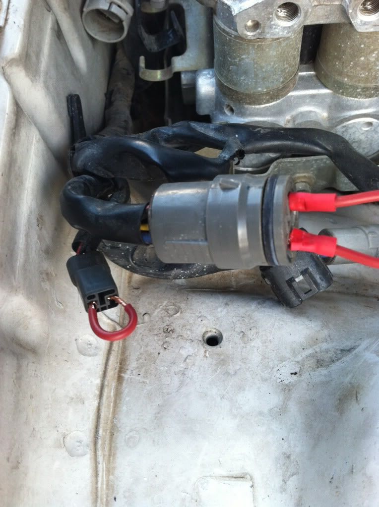

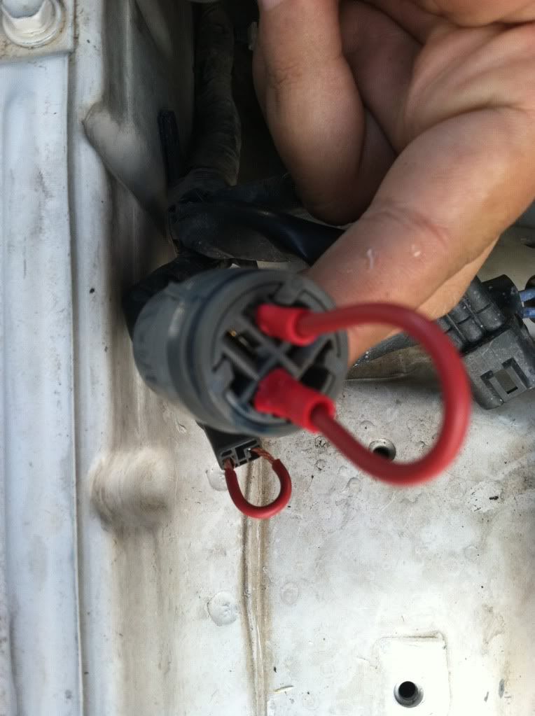

so i just tried to bypass the the relay by the pass side strut tower (wire colors were the same) it didn't work...:dunno:? i even tried to jumper the fuel at the diagnostics box jumping B+ to Fp and nothing. the EFI fuses are all fine.
pics of how i jumpered things. let me know if i did it wrong.

Do you have power at the B+ pin?
Jumping FP and B+ bypasses the entire control system. So time to start looking elsewhere.
If you do have power at B+ (with the key on). next see if that sends power to the pump (remove the plate in the trunk). If you do have power, its a bad pump, if not, an open power wire (black with red).
