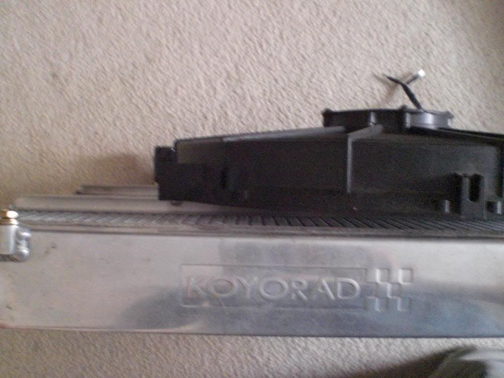

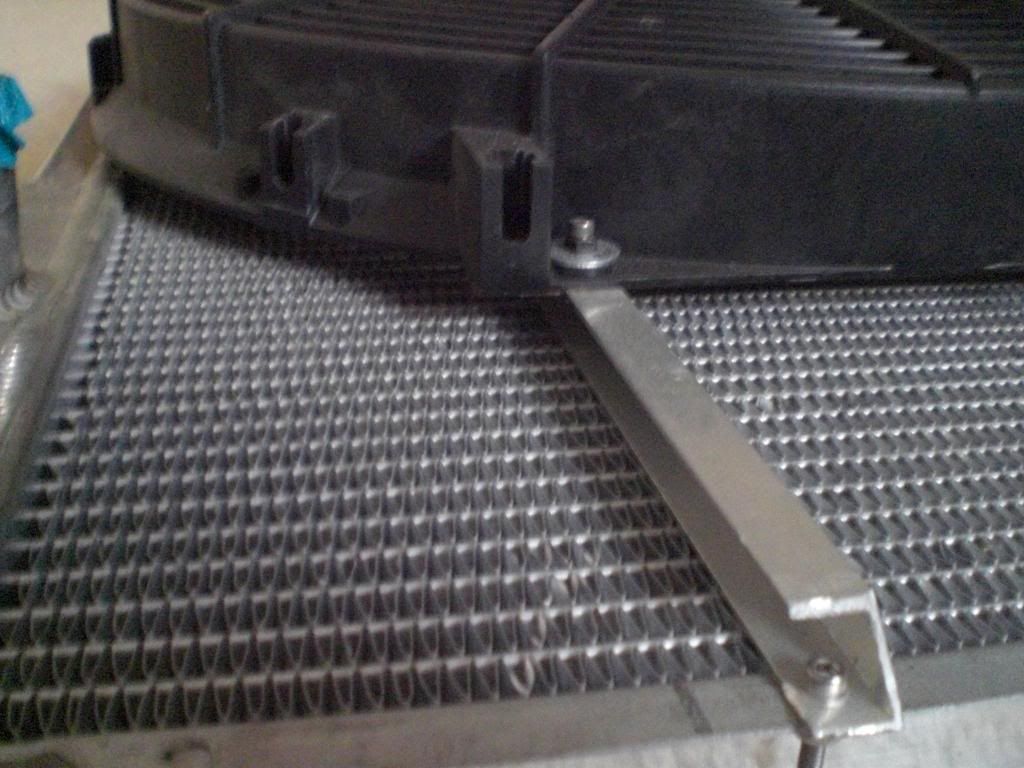

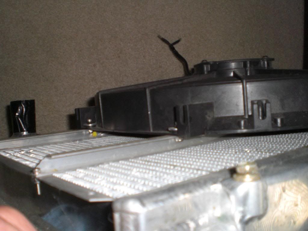

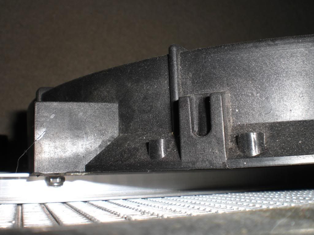

There are twin elecrtic fan kits out there for around $225. They come with two 12in electric fans and a nice shroud. Ive heard that they work like a champ. I bought a low amp 16in fan and made my own mount out of some alum C-channel. It flows plenty up hill or down, traffic or not. If your windows work and you have A/C, take it out and drive faster with the windows down.:icon_razz. The stock pullie will work just fine with the right size bolts without the fan on it. Might need a 1 or 2mm shim, maybe.
