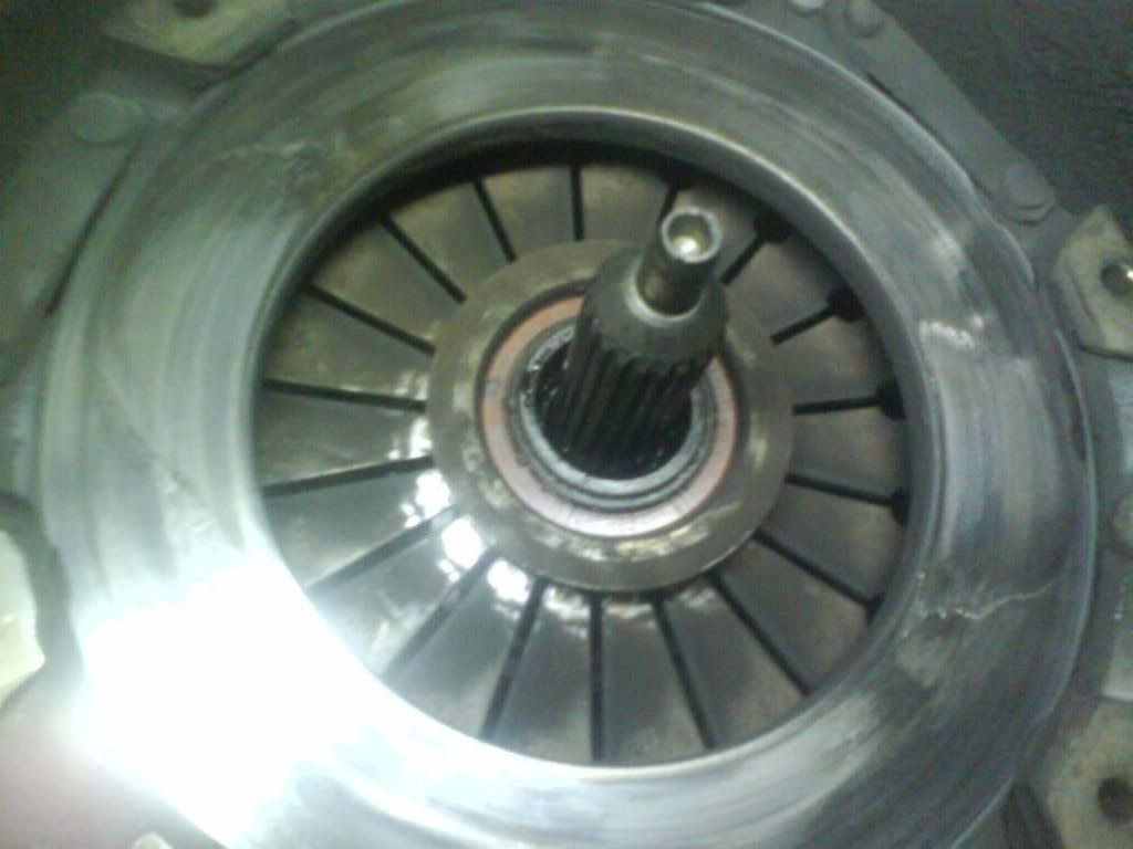

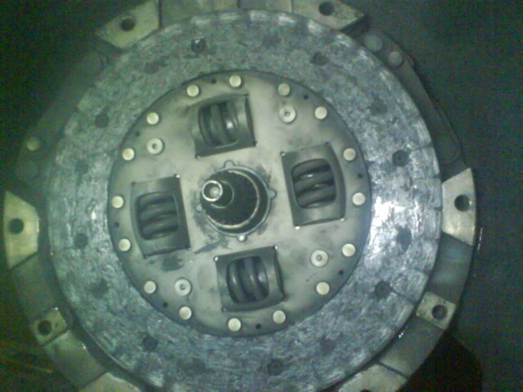

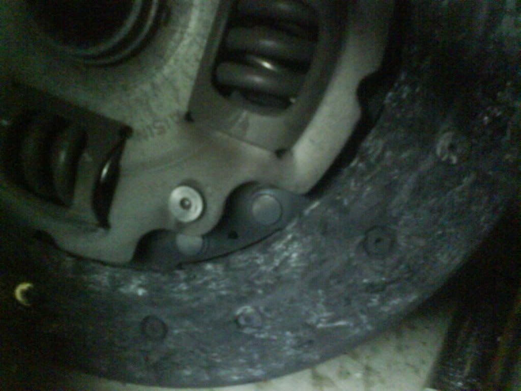

OEM clutch disc to flywheel
Debris @ 12 o'clock rivet on flywheel side of clutch disc

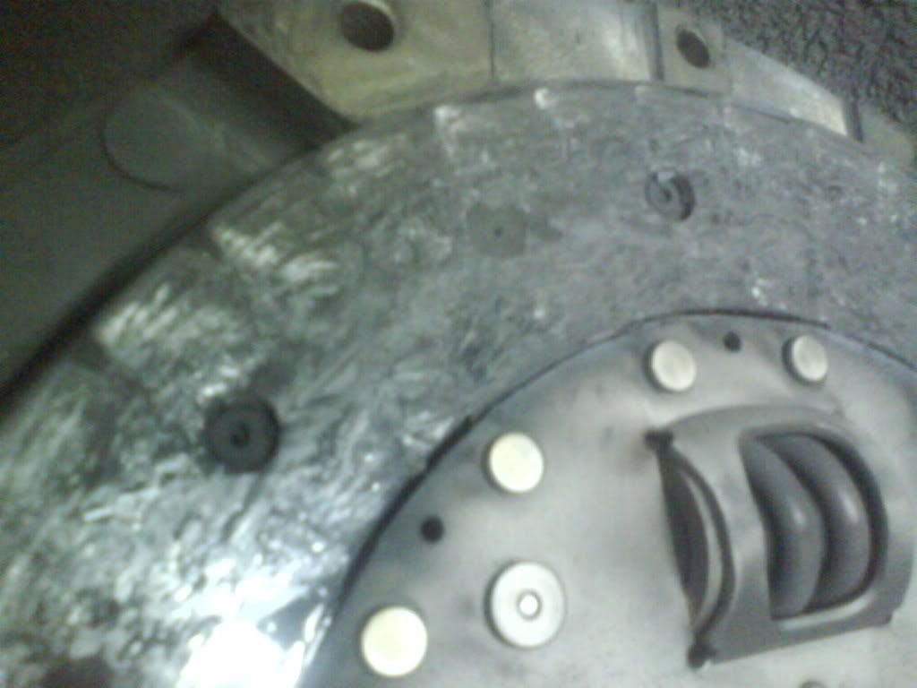

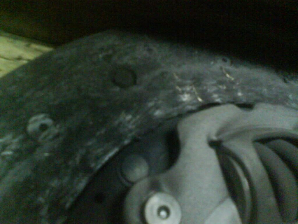

Clutch disc to pressure plate side, worn to rivet= need new pp now :)
Most worn spot on clutch disc to pressure plate side, Definitely got down to the rivets

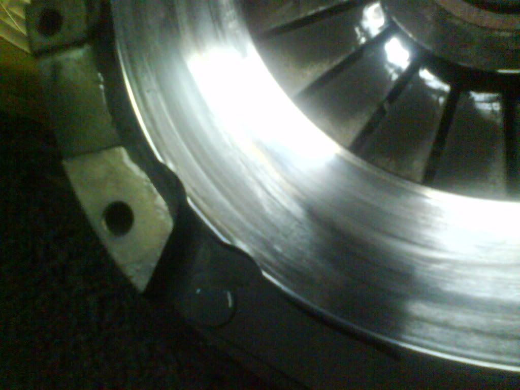

OEM pressure plate , has heat marks
Seen these missing parts on the circumference of the pressure plate, all around but not perfectly spaced so i don't know what if it's there due to casting

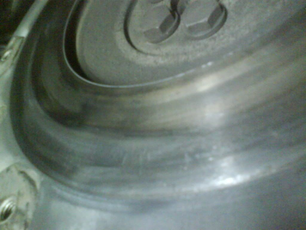

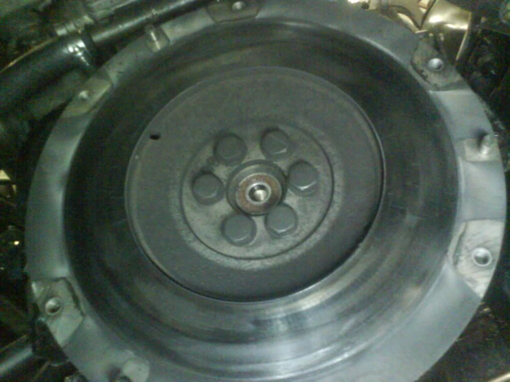

OEM flywheel, has some signs of heat
Flywheel close up, no grooves or gouges or even a wear path, just the heat spotting

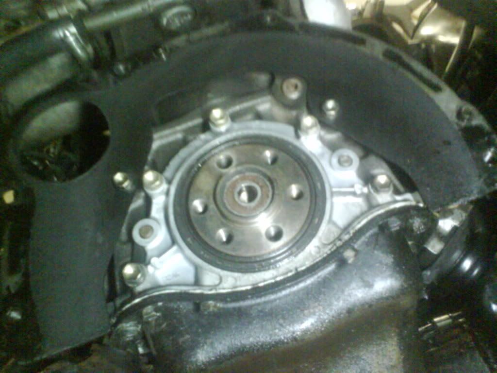

Good rear main seal
I believe i fryed my clutch when i put in 2.5" intercooler piping at the same time as a pretty large turbo, supposedly a t70 with integrated waste gate from precision. Waste gate is 13 lbs if i recall. It has a 4" intake and 2.5" out.
Lipp turbo elbow, megan DP, high flow cat, fart can, 4" kn filter, maft pro not using boost controller with 11.8 AFRs
I haven't dynoed.
-Dave
Poodles
I play with fire
Jul 22, 2006
16,757
Fort Worth, TX
-Pressure plate should have those cutouts.
-Clutch is toast, don't reuse the pressure plate, get a whole kit.
-Inspect flywheel for cracks, mine had them after the stock clutch took a crap on me.
