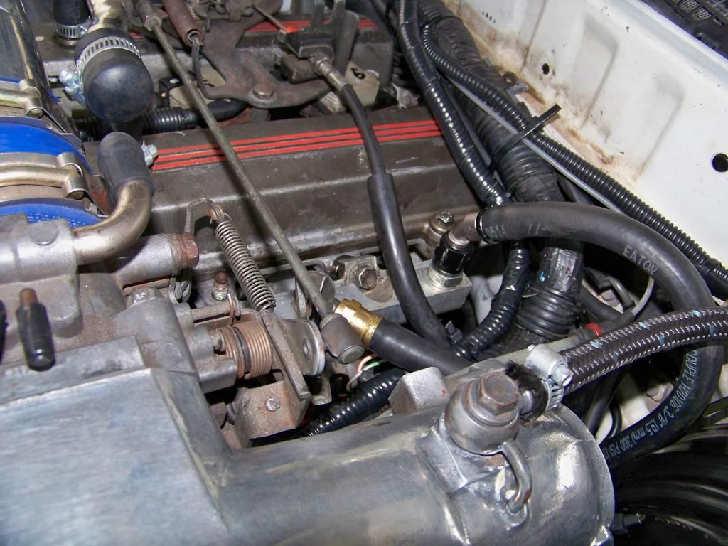

basically my questions is how are people running a dual feed fuel rail while still having the stock fuel lines?
Currently has a single turbo 2jzgte and im looking to do some fuel upgrades. Vehicle has complete stock lines with an aeromotive stealth fuel pump in tank, looking of going top feed and some 650cc injectors. Any tips appreciated, Thanks

Not really any point as your not flowing enough fuel through stock lines to need dual feed. If you wanted to tho you just need a y adapter.

makes sense, How about blocking the center return and using the front feed as the return? Will that be capable to fuel up to 450whp?

I'm feeding the rail from the front and back, and using the middle as the return to the regulator. I used a y adapter and -6 an fittings with push lock hose.

Thanks for the response, Have any pics of routing and mounting the fpr location?
