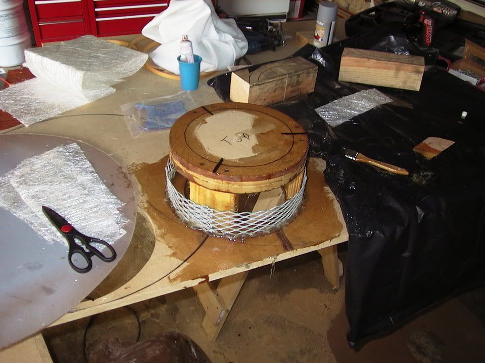

Well guys im at it finally. I have finally saved up the cash to build a custom enclosure for my 2 RE's to go in the spare tire well and also incorporate an amp rack for the 2 amps i have...
I so far just have the bas molded in and a sheet of MDF mounted to it. Im in the process of mounting the rings and figuring exactly what i want the box to look like, as well as getting the proper displacement set, which should be around 3.2 cu/ft.
Here are some pics for now, and plenty more to come!
Whats to go in!
The glass tub.
Mounted to the MDF

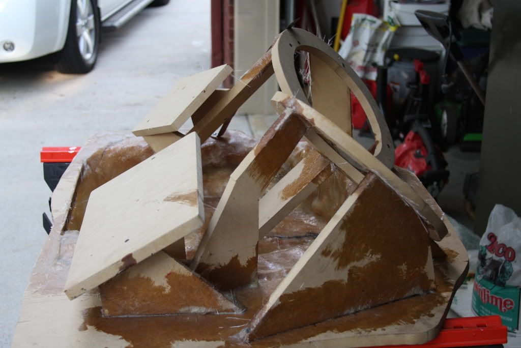

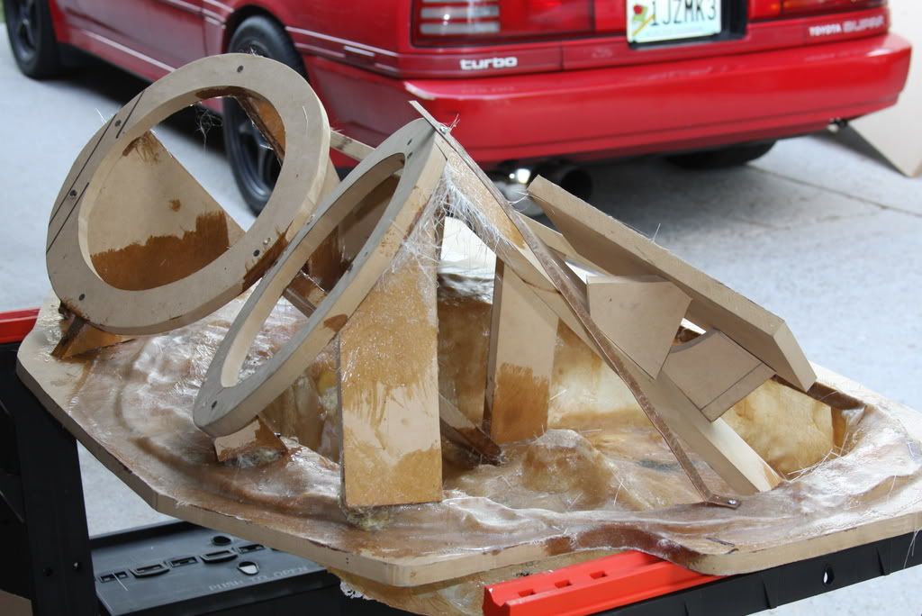

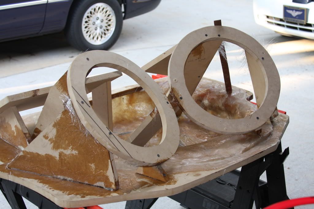

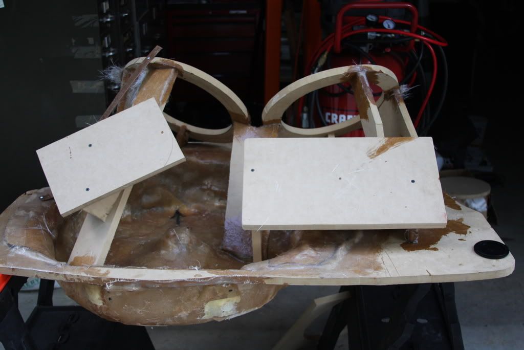

Well i have framed in the 2 subs and the amp racks i wanted. Glasses them in to strengthen it all, so now all thats left is to stretch the felt over all of it and do some final layers! Heres some pics to keep you guys happy!
Let me know what you think.

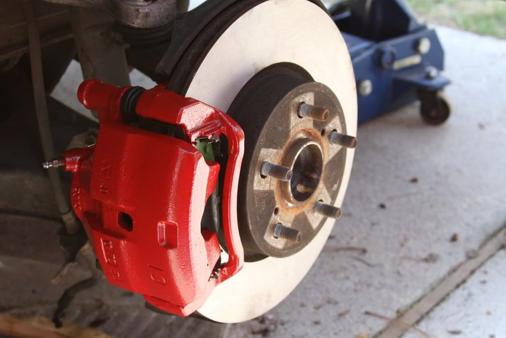

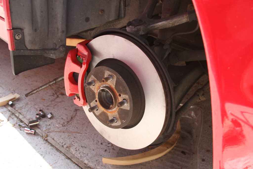

Oh and a little painting i did on the calipers after i rebuilt them last week.

ahhhh...yes I see now where ypu are getting the volume. Although now Im wondering why even use the spare tire space at all. but that looks cool...if you are into that sort of thing. FAR too obtrusive for me. Im just more about the stealth look.

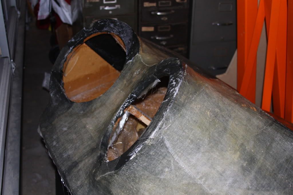

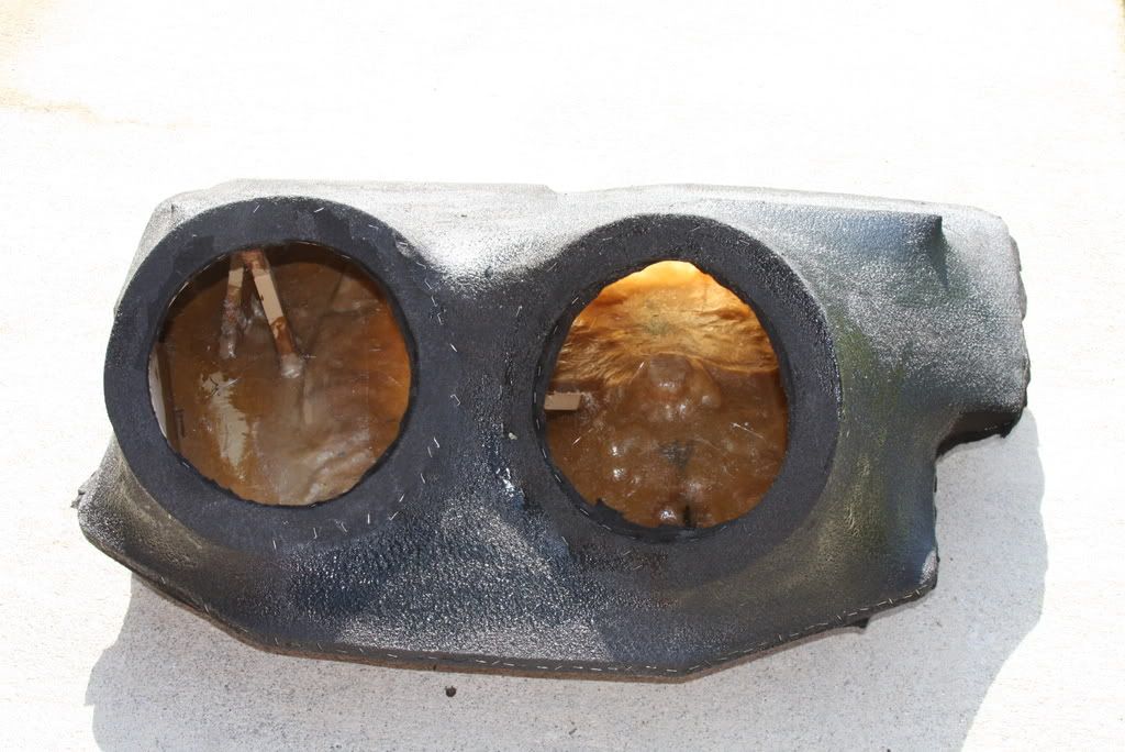

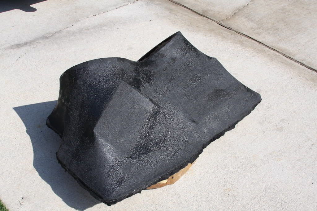

***update
Well i got the felt stretched over the fram and resin applied. I ran out of resin so the project is on hold till next paycheck... I decided how im going to run the wires, but you will just have to wait and see how thats done, i dont feel like explaining.
Updates will follow when i make more progress.... In the mean time thanks for all the suppord, opinions and discriminations!

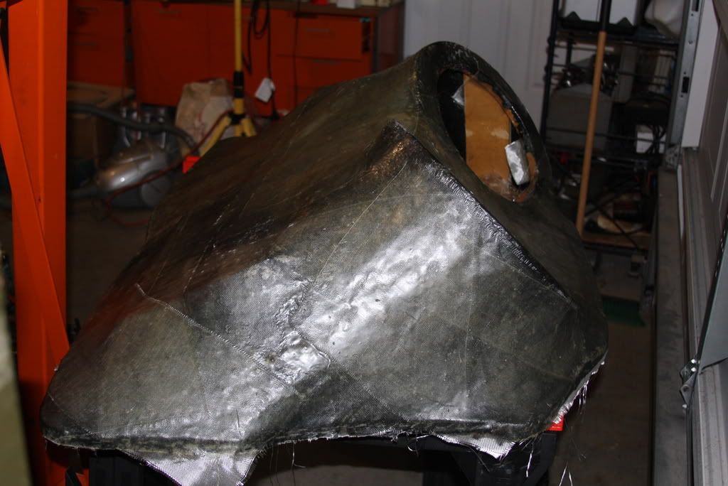

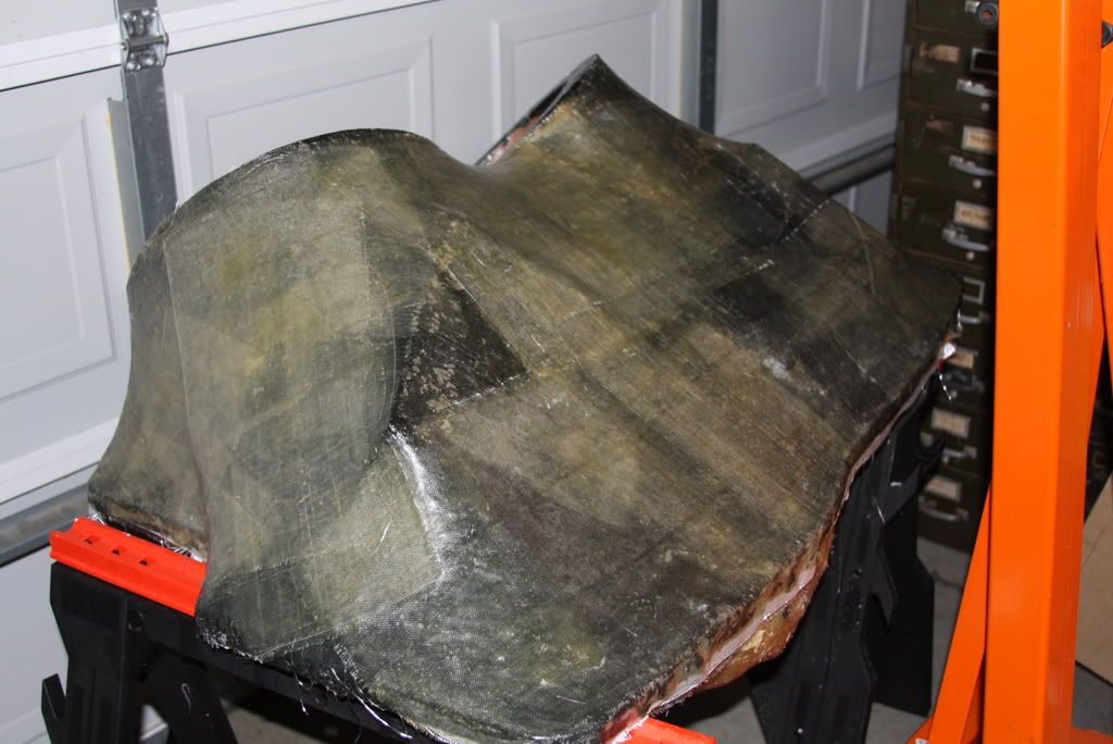

Update**

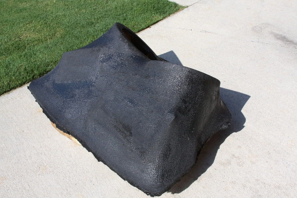

Well i am getting ever so close to being done. All i have left now is to put one final layer of glass on the box, then i get to bondo/filler the out side and sand it smotth then its ready for paint! :)
Here are a few pics of the box so far. There is about 3-4 layers of glass on the box as of now. Its pretty solid and virtually has no flex at all when you press on it with your finger. So im doing one more layer and then i think it should be good.

lol! weights. my box with sub in it is 74lbs. and is roughly .9cuft.
it would be a little lighter if I didnt go way overkill reinforcing the heck out of it with like 10 layers or so of fiberglass. It was my first fiberglass box and didnt realize how strong this stuff actually was. I could probably run it over with my truck and not crack it. I'm planning on making another one a lot lighter for a shallow mount 8 or 10" sub that sits flush with the carpet instead of sticking up like my 10w7 does. its also a little overkill for my actual listening tastes. lesson learned... anybody wanna buy it?

Ill surely post weight when done. but from the feel of it, the box probably weighs about 65-75lbs so far.... lol :( Then each sub weighs 26lbs, and the 2 amps i have are about another 15lbs.
Audio man, you did very nice glass work. I wish i had only spend a little more time on the actual tire well, you layed everything very smooth on yours, mine was done very quickly and poorly, i have a bunch of bubbles in mine which look terrible. But anyways yours looks great!
