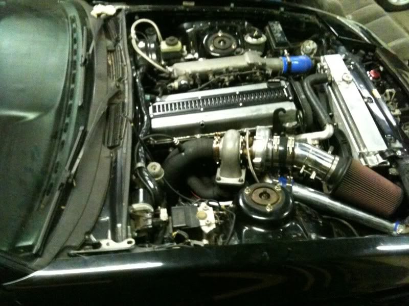

supra1008;1541029 said:I like it so far. In my old car, I was pushing 350rwhp at 15psi w/ no tune running really rich. I was tuning with Mines Tuned ECU and a SAFC NEO but hadn't tweaked it yet. No cams. I have the .70a/r
more pics:
http://www.supramania.com/forums/showthread.php?118182-My-Black-91-Project&p=1540876#post1540876
supra1008;1541843 said:I have stock injectors and I am fine...Still running rich with 380s at 350rwhp
