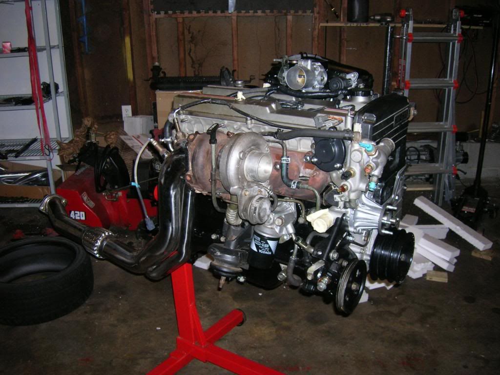

First iteration:
Later iteration:

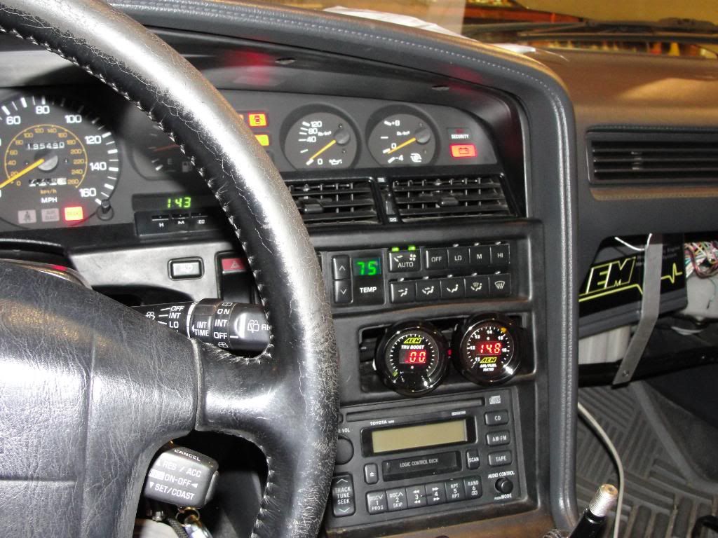

Pointing to the trans or away? Where did you send the wire harness through. I'm about to install mine here soon. I was thinking horizontal pointing away from the trans, and sending the harness through the body plug underneath the passenger floor. I'd run the harness under the carpet and up behind the dash somewhere. Bad thing about that is passengers would be stepping on the wire harness.
toyotanos
What will we break today?
Super Moderator
Nov 29, 2008
2,841
Coon Rapids, MN
I had mine angled slightly toward the trans (~10:30-11 o'clock). As for the harness, I tucked it behind the speedo cable shield to help ward the wires from heat and zip-tied it there for security.
My gauge is where the ashtray once was, so all the wires run through the engine wiring harness grommet.
Edit: yep, I welded it in place there- it has a lot of clearance when you are down there, it just looks scary when its not in the car.
ForcedTorque
Join the 92 Owners Group
Jul 11, 2005
6,099
58
I ran my wiring up through the shifter hole. It comes through, and can be run into the dash behind the radio bezel. That way, no passengers will ever get close to it. The car has never seen the road, and the wideband has been sold off, so I'll never know just how good that would have worked.

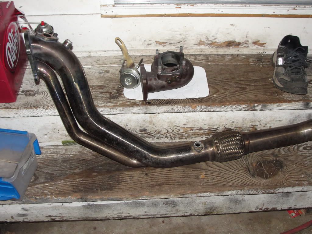

nofx230
Jan 24, 2012
132
Colorado
checked the car today and the down pipe has a bubble in it, i thought it was a cat but nope just a bubble lie an expansion chamber and theres a pre welded bung 18 inches down the pipe again i just bought this car so not certain whats going on with it
