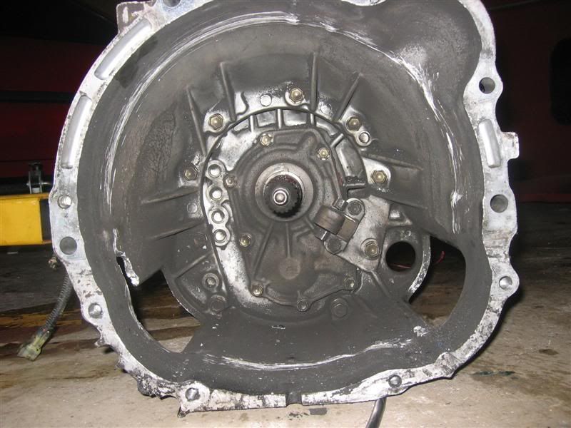

I finally got around to looking at it today and this is what I found:
vbpgimage.php
You can see the cracked bulge pretty well in the picture, but there is also a single crack that runs the whole length of the bell housing horizontal in the picture and up on to where the engine mounts to the bell housing.
vbpgimage.php

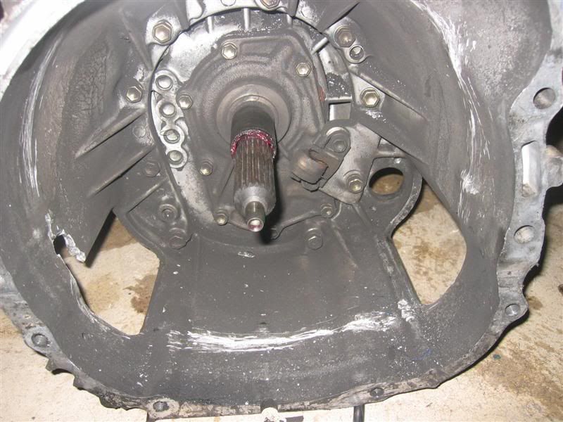

In this picture you can see where the pressure plate has hit along the bell housing. If you put your fingers in there, the gap between the pressure plate and the bell housing is very small.
As far as I can tell, the clutch still works fine, the transmission still shifts fine, it's just the pressure plate and bell housing. All things considered, I think the pressure plate got a little loose and then, with all the pedal working and extreme conditions, the hardware gave out. I don't think it's the flywheel because the starter still works fine.
This is as far as I've gone today, and I will probably be pulling the transmission out this weekend to see for sure what happened and what will need to be replaced. Worst case scenario: transmission shaft bent. Best case scenario: all I have to replace is the bell housing and some hardware.

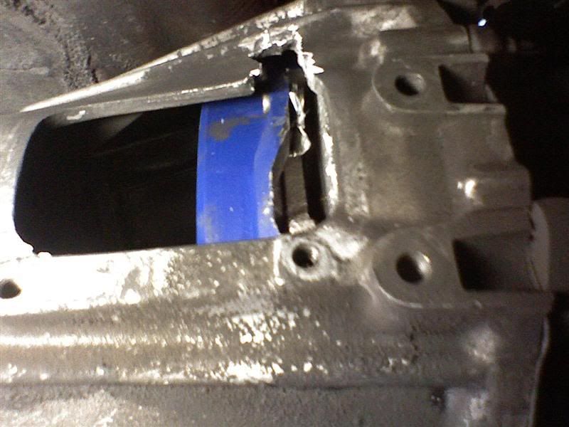

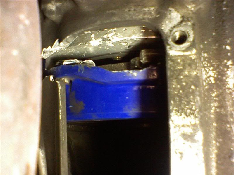

This last weekend I was finally able to take the transmission out and see what really happened. Turns out the pressure plate casting broke and tore out a huge chunk of the bell housing. I got everything put back together and I'm back on the road again.
Here is what I saw when I tore everything apart:

Never heard of misaligning a PP. The locate pins usually do a great job of keeping everything in line. Maybe those sheared off?
Usually a bad shift that causes damage is confined to the gearbox itself, but I have seen some pressure plates explode (did so myself on my 67 Chevelle, turning the flywheel sounded like marbles in a can. But you dont have parts rattling around. Damaged input shaft? Hope not, that more expensive to fix. Good luck on that.
62
I'd "guess" it's either broken a drive strap or bent one enough to allow the casting to pop out to the side...
Either way I wouldn't be still driving it till it's inspected and that bellhousing replaced.

Yeah, the last I drove it was to limp it home from the track. It's been sitting in the garage while I drive an old previa mini van around :p (I'm buying a ~2000 tacoma pretty soon to be my daily driver).
I'm hoping it's not the input shaft for the tranny. But then if it was that, then the pressure plate wouldn't have hit the bell housing and wouldn't have all those marks on it because the pressure plate is attached to the flywheel. Then again, the crank could be bent right at the rear, causing the whole flywheel assembly to wobble around (that would be the new worst case scenario :/). I'll just have to wait to see when I pull it apart and check it out.
