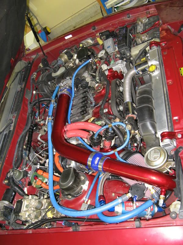

I made mine up with mild steel, mandrel bends and straight pipe.
It is 3" ID at the throttle body, and 2.5" from there to the FMIC, and another 2.5" from the IC to a single shorter 2.25" ID pipe off the turbo. (The actual ID of the turbo outlet is more like 2.25, not 2.5 I've found in many cases.)
I've powdercoated this set of pipes twice.. Once in white with a black vein.. looks "hammertone" in the photos, and now candy apple red with a clear coat..
Made my own custom down pipe, and modified the "chinabay" stainless manifold as needed to get it exactly like I wanted.
Here is how they used to look.

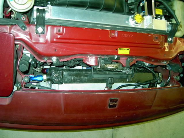

My FMIC is not as big as IJ's, but I'm not sure that's a bad thing.. the oil cooler might not fit if the IC was any larger. (I just TIG welded the RX7 cooler mounting brackets to the end tanks of the intercooler, and there is a good 3/4" air gap between them, with only a few inches of each mounting bracket touching between the two, so not much heat transfer from the oil cooler to the FMIC.

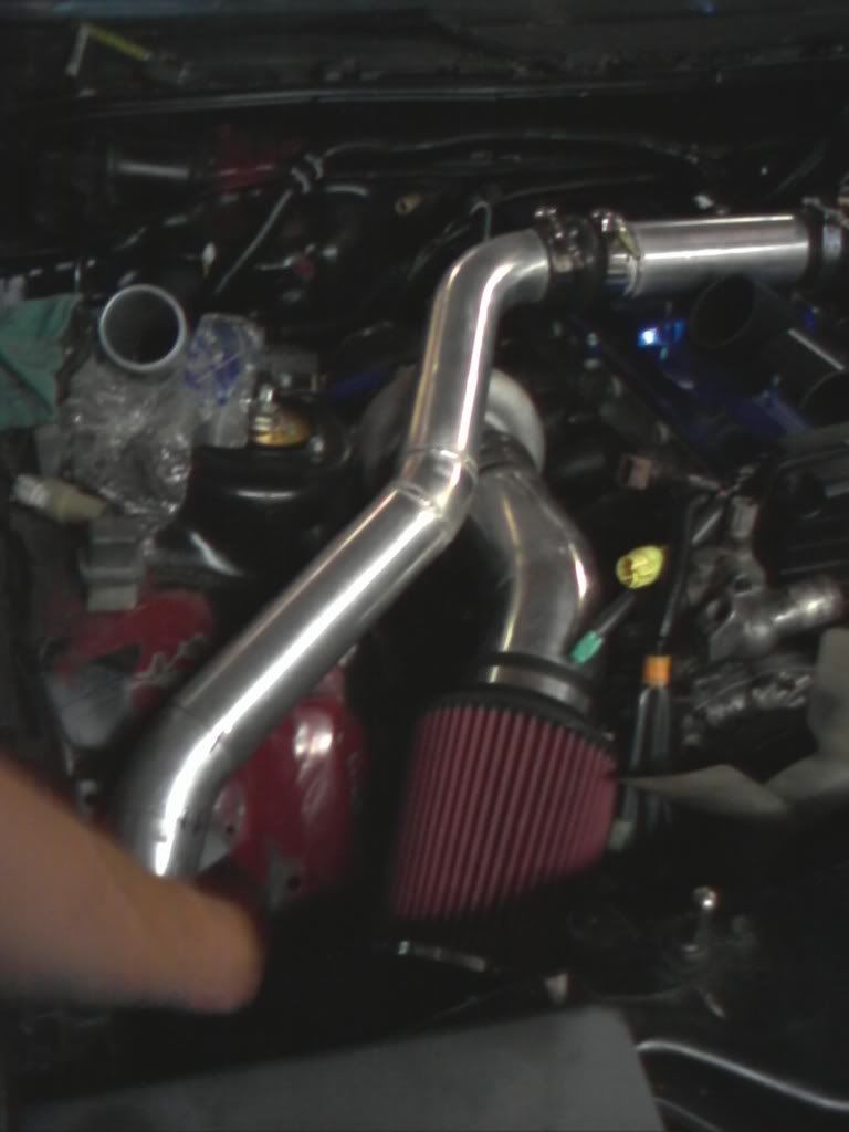

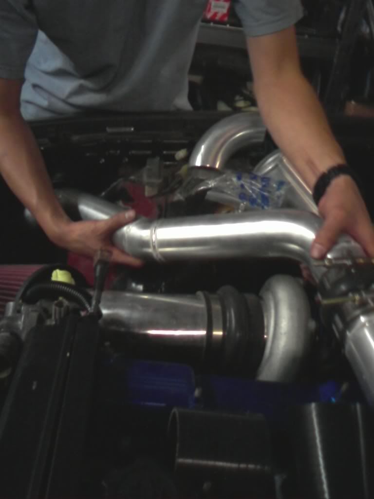

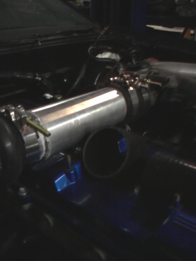

Here are some Custom Hardpipes we made for a customer, so I guess you can consider them DIY since they are built for the customer's particular setup:
Custom 3000 Pipe
RayRay getting it ready to weld the next piece
Mocking it up
Mocking up the rest so Ernie can weld it
