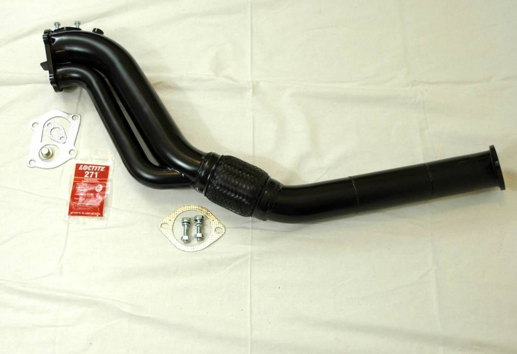

Hi all, this is my first post here. A very good friend of mine bought the justspeed divorced downpipe for me for Christmas this year. I want to have the tab welded on that is on the BIC downpipe or a piece of tubing instead. Would love to know your opinions on which is better and more inportantly, does anyone know the exact dimensions of the tab or do I need to remove the turbo and take it to the welder in order to be accurate?
Also, should i just use a dremel to modify the gasket after the tab is welded on or should i find another solution? Thanks for your help.

DO NOT BUY EBAY DDP. I bought one and it was absolute fail. Didn't even fit evenly to the backside of the turbo. On top of that it hit my firewall obviously it wasn't for a mk3. I even banged the shit out my firewall it finally cleared but still didn't fit flush with the back if the turbo. The surface on the ddp flange wasn't level.
http://item.mobileweb.ebay.com/view...0481531634&index=0&nav=SEARCH&nid=53310662653
^^^^^^DONT BUY
IMO just spend the extra $100 or so for quality. Trust me I learned the hard way.
Now my gf has the DM full 3in it's alright I'd still rather have a bic ddp or some other custom ddp.
