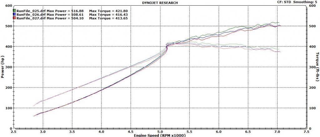

So i finally got around to getting a decent tune in my car. Heres the vid and sheet.
[video=youtube;xdhD-ksAXPQ]https://www.youtube.com/watch?v=xdhD-ksAXPQ[/video]
Looks like i need to rev higher then 7000rpm. :love:

Haha its in the video but ill leave this here anyway. It looks funky at 5k because thats where it "loaded" the rollers. Oh and thats only 20psi.

Question for those who know. Do you brake boost the car before hitting start button so that the low end numbers are realistic? The dyno didnt load the car at all untill it started to make boost, thats why it looks so laggy. But on the street i easily see 5+psi at 3200ish. If i hit the trans brake i can have 10+psi under 3500rpm. I was wondering if when i go back i should brake boost it to just get a little bit of boost up so that it loads earlier (hopefully, not sure how it knows when to load) so i can get a full run on boost rather then just 5krpm and up.

Thanks man! Bone stock 2JZGE, with bc272's springs and retainers and a 1.8mm head gasket. A Precision 6466, custom FFIM, and 3" downpipe to a 4" exhaust.
Can't wait to fix my diff and go back. Hoping for 550-600 on 25psi.
