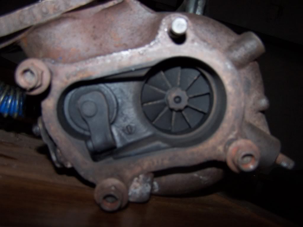

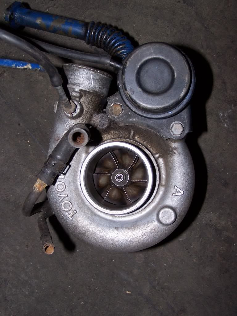

anyone know exactly what type of CT26 this is just from this picture
trim size, identification of compressor wheel from the fins?
Thanks, couldn't find a thread that hinted at things to look for from a simple picture
TomFraser
This thread is slowly being answered by me as I continue to search
it looks like a T04e compressor wheel... problem is these are in 54, 57 and 60 trim, and I cannot tell from the picture what size it is, again... this is all my guesswork, anyone else?

to me it looks like a 57 trim or a 60 trim. all upgraded cts have 6 blades and usually use garrett wheels. looks to be slightly more bored out than my 57 trim.
you could always measure it to be sure.
