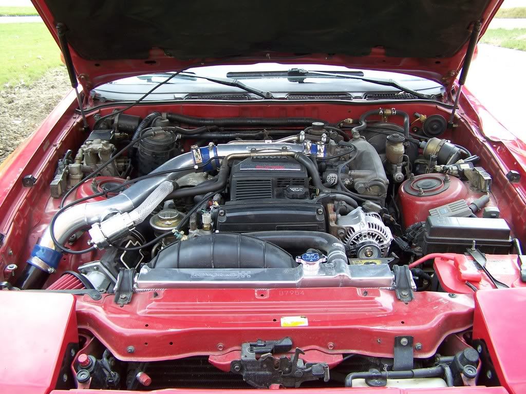

(never before seen pic of my buildup...)
