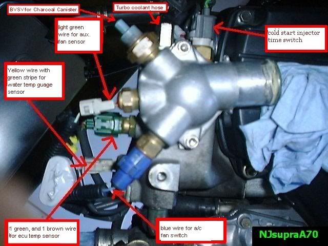

my check engine light comes on as i go down the road but if stop and turn the car off the light goes off but might come on later plus my temp gauge is not working could this be the temp sensor or the thermostat.or mybe something else need some help.if u have any ideas. thanks :1zhelp:

edit: also check that the temp sensor is connected -

You said your temp gauge did not work. Make sure all the sensors are connected correctly on that pic I posted in your other thread.
Also check AFM, O2.
