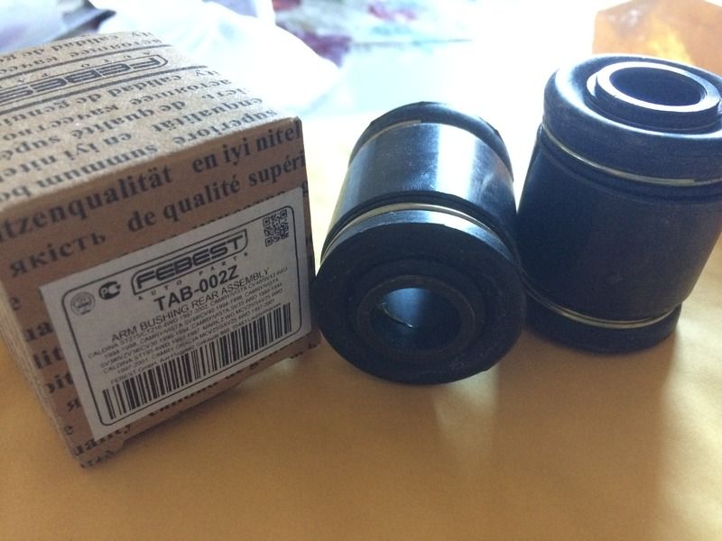

But the Camry of certain years uses the exact same spherical bushing we use in our rear spindle and a brand called Febest makes them for that application so I got them and they looked like pretty good quality and when i got them was rather impressed. They were nice and tight when they pivot. Anyways got them for about $17 shipped each on eBay and replaced them and now my rear wheels are nice and tight.
Febest part number is TAB-002Z. Anyways just wanted to share incase another relatively poor mk3 owner wants to replace their spherical bushings but don't want to buy the expensive Toyota ones. And just in case you were wondering, YES they were a bitch and a half to get in and out. I did it on the car using an extensive contraption of long bolts and giant sockets to pull out the old ones and effectively press in the new ones. Not very easy without a press
Heres an ebay link: http://www.ebay.com/itm/Arm-Bushing-For-Rear-Assembly-Febest-TAB-002Z-/281417727433?pt=Motors_Car_Truck_Parts_Accessories&hash=item4185cdbdc9&vxp=mtr

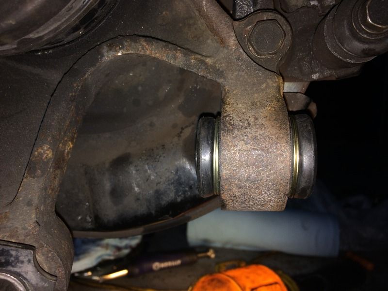

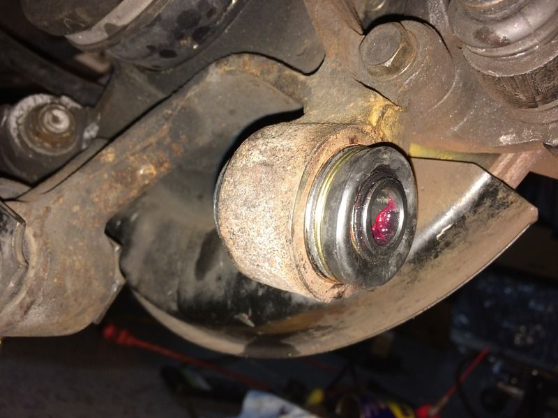

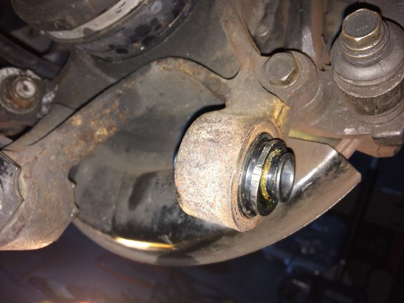

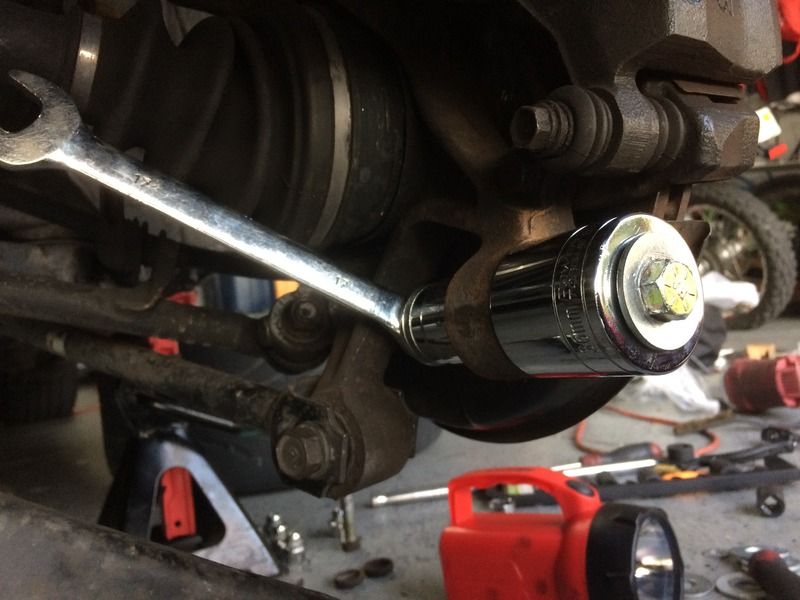

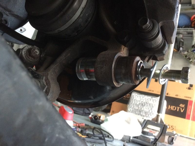

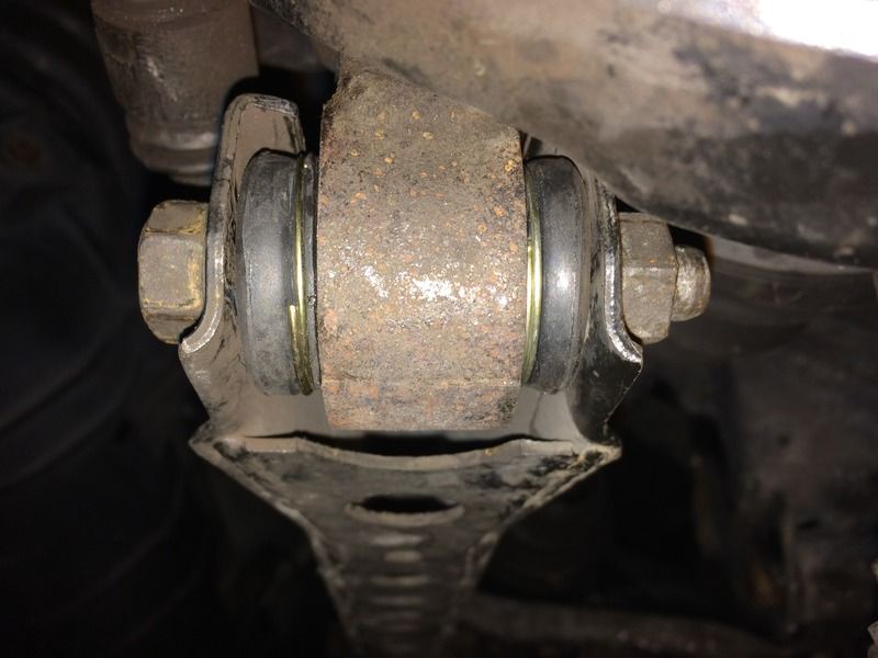

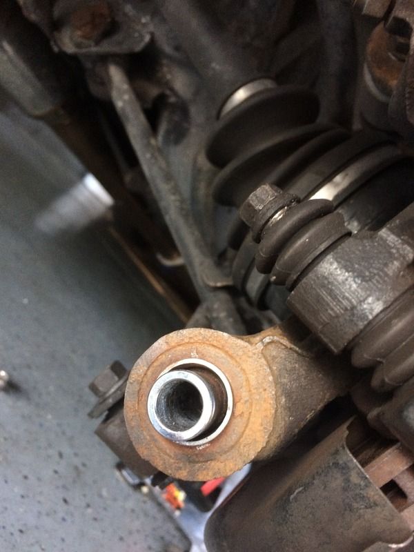

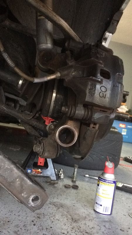

Thanks to this thread i went ahead and purchased these spherical bushings. Quality looks pretty decent, greatly improved the suspension in the rear and it fixed the excessive play it had.
Here are some pics of the replacement of the spherical bushings while the hub is still on the supra..
I used a variety of sockets, bolts, nuts, washers and some heat.
old worn out stocker:
New one going in
just a tip when going to replace the bushings use grade 8 bolts, 1/2 impact driver and at least a small propane torch..
