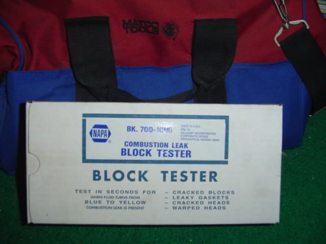

ha yea i tried that bro.. bought the kit from napa and then when i hooked the kit up after about 5 minutes coolant started to push up through the test tube and flowing through the top like a water fountain and shooting like 4 feet high. it pushed all the test blue liquid right out.. couldnt even use the damn thing. i dont even know what to do.

OK. You said you used the block tester, but you had coolant come spraying at you at high velocity. The test only takes < 60 seconds, how much coolant did you drain before you tested it? If you are having problems, drain the entire radiator and test it. Don't forget to plug the overflow port on the radiator while testing, the tester will suck fresh air or coolant (whichever is present in the overflow) if you do not block this off while testing, resulting in a false negative reading.
Reread the block tester's instructions.

Better yet. If you can't figure out how to properly use that test kit, go to an aquarium store, or hell, even Wal Mart and buy a Ph test kit and READ the instructions, use a sample of your collant (buy a chicken baster or something if you have to) and then report back you findings on what Ph it's at.

that might be the problem that i didnt block the radiator overflow port.
