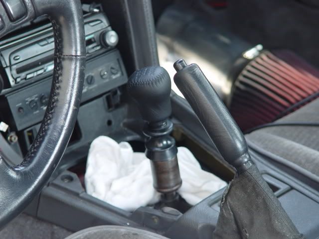

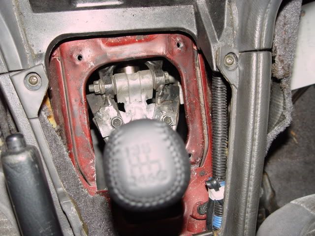

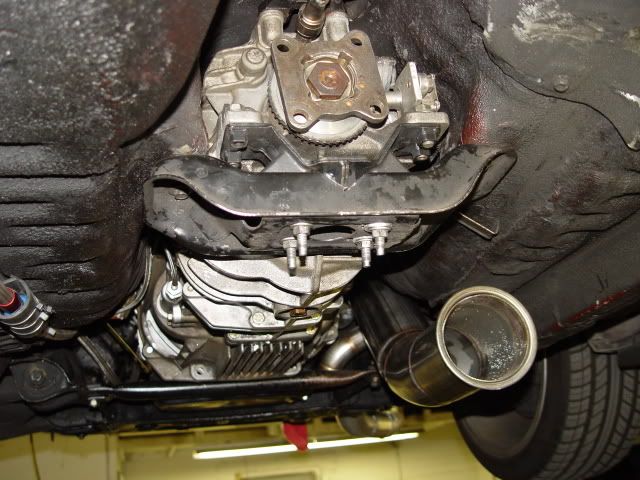

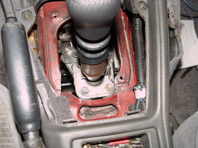

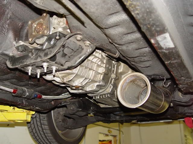

2jzmk3
Guest
suprarich said:
I second that. Sean says it was an easy install and not hard to shift at all.
yea it was fairly easy. but i have the resources to make it a easy swap. one of the hardest parts was making the shifter cage to work.. i have a 3.73 rear end in there now, and to me it wasnt much of a difference from the 5spd.
im glad i went with the 6spd since i will no longer have clutch/tranny problems.
i just got a 3.54 gearing from Jawsgear to put in mine, so it should be a little better. he may have more, you will have to contact him..
here are a few pics...
