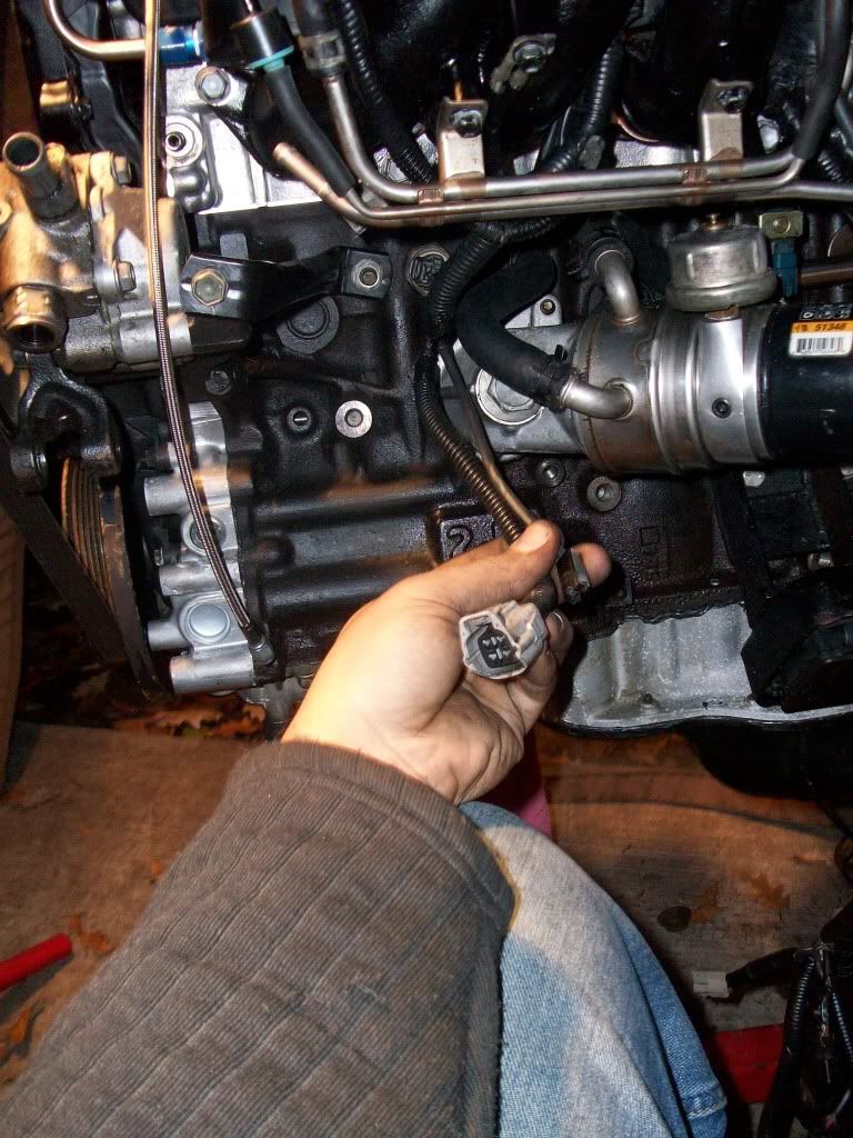

Sorry im getting frustrated trying to figure this out. But im sure someone can help me. Just need the sensors on here labeled... thanks in advance.

Ok here goes, top left & right knock sensors, bottom left near oil pump is a oil pressure sensor (connect DM line to 7M pressure sensor to read PSI on your gauge). Two black sensors on head (one by hook) cam position sensor
I think that covers it...

OneJArpus;1532015 said:
You can also hook up the sensor to a adaptor for the oil filter housing.
I didnt have a sensor on my 2j so i used the one on my 1j and it blocked it as i did not have the DM line.
That is certainly a great idea too. The motor I did so far, has the DM line, it is kind of nice how easy it is to access.
