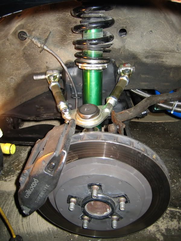

Here is a picture of arms sources from HRP on DrJonez Car:
And
Here they are on my car.
