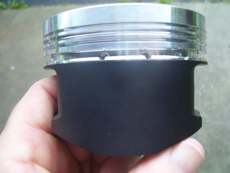

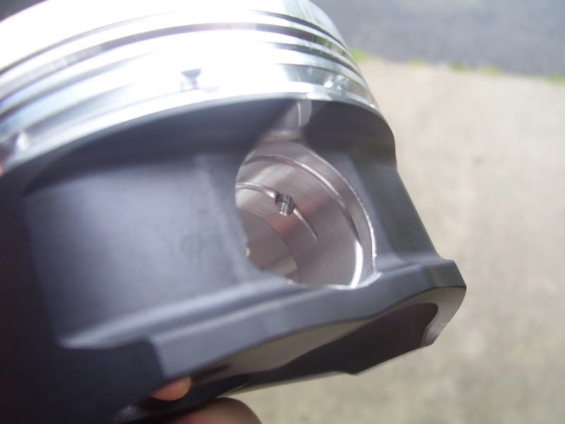

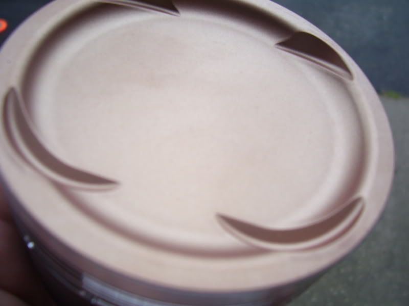

Pics of the CP pistons:

Coating pistons is not something I want to invest the time in...it would drive me nuts and if you screw-up, a lot of $$$ too. The coating is a factory option when you order these...in fact, each order (other than the .040 over) are custom made. These are .020 over and I opted for the upgraded wrist pins. What really got my attention is the double forced pin oilers...should be a very good upgrade.
