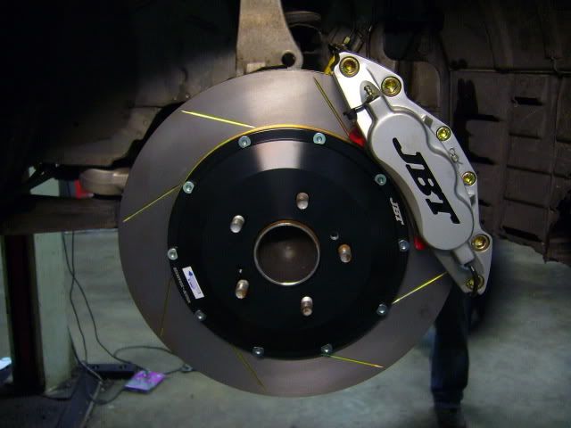

And i think there is e few japanese site selling more brake kits for the Mk3
Greddy makes one bremo make a complete brake for the mark 3
And JBT is selling a kit for the Mk3 they sell 355 and 320 mm rotors (14 and 13 inch)

For the brembo you must use costum brackets
And for the 300 ZX calipers you can use the nightpager brackets and there is a few people selling them are have a set to duplicate
I think the JBT is the real deal butt i don not know anything about the price for those kits
Check
Its look more sexy then the wilwood kit

I think I still like the willwood kit better as far as looks though. That is just me. I do like those JBT also though. How many pistons are they? and are the pistons on both sides or just one?
4 piston or 6 piston so both side just like the wilwoods
I do not know the price for the JBT so maybe the wilwood kit is a nice deal
O do not see the JBT listed on some website with price
Maybe the gone e be the sme price as rotora are something (not cheap)

I just looked at the picture again and duh, I am retarded. It is shaped to show the three pistons on this one side. Man am I retarded.
That is what I was thinking.
