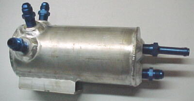

i have seen several 044 setups with a surge tank. this design works pretty well.
here is a surge tank made from 3" exhaust tubing

remember though, the intake pump doesn't have any pressure to it, so will flow to its full potential. Given its a decent pump (at least a walbro 255) it should be plenty of flow for the bosch 044 @ 50+psi.

how big does this surge tank need to be?
would 1qt be sufficient, or is there a need for something bigger?
I have some 4" left over from when I did my exhaust that I'm thinking about making one with...

Sure, go w/ 4". I'm actually in the process of developing a high horsepower fuel system that you guys could just buy and bolt in for the MKIII. Using Aeromotive pumps and filters and a custom surge tank. AN fittings included.
The diameter of the tank we're making is 4" as well. If you're not pushin past 14psi with your gt40 you should be fine with the 255 in tank. That would be a different story if you were going with really high boost, something crazy that could drain the surge tank faster than the 255 could pump. But even if it did so the Walbro wouldnt fail, you would lean out. So to sum it up, tank good & Walbro will be OK

We were planning on making a 2L tank, mounting brackets for the whole system would keep the external pump, pump controller, filter, & tank all localized and secure in the trunk.
