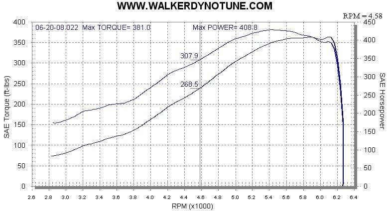

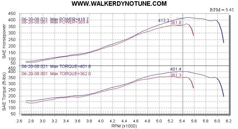

Finally got up to AL. for some dyno and tuning. Big thanks to Jay for all his help. He met me at dyno and helped out ton's. Well onto the results. I wanted a safe daily driving tune on pump gas and safe timing also.
Info about setup. Running a T66/ ala driftmotion, bigger spearco replica ic, 750 rc injectors and stinger standalone. Exhaust is through a RSR. Boost is set at max of 17lbs. Will get a more aggressive tune and higher boost dyno in the future. Second graph is daily driving setup.
Overall I'm a little dissappointed but I can think of worse things.
footnote: Did 2 pulls against Suprahero and he is still faster:3d_frown:

Stock internals except a titan mhg and arp studs. I agree not bad for conservative tune.
Get some cams, and you will fall in love, and pick up a good amount.

rs4rush;1063753 said:
Life begins at 20PSI ;) Seems like pretty decent numbers on a safe tune. :arcadefre
Truer words have never been spoken. You can really tell by the sound that the turbo wants to go to about 25-30psi, but we kept a tight leash on it and never let it get past 17 except for one quick spike to 21 before we adjusted the boost cut with the stinger. The tune is very conservative and should last George forever which for a 7m is about a month...................just kidding......:evil2:

Easy fix. Put in the C16, turn up the boost. That turbo is a dog until you get to mid 20s. There's most likely nothing wrong with the car. Put in a 75 shot and you'll have an animal.
