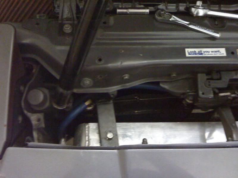

Some pics of how I have mine done. It's mounted with a 1/4" thick bracket from the top of cooler, to the top portion of rad/core support there, then bolted at the bottom to the lower portion of the core support.
Obviously it's behind the IC in front of the rad, and I'm still using the a clutch fan so I figured it couldn't hurt having it mounted more towards the passenger side of the car to take advantage of the air the fan is pulling through. One note, I don't have A/C on the car anymore at all so there is much more room to work with there because of the lack of condenser. But I would think you could still put a decent sized cooler in there even with it in place.
Sorry for the crappy pics, I only have a 3G iphone..:icon_bigg

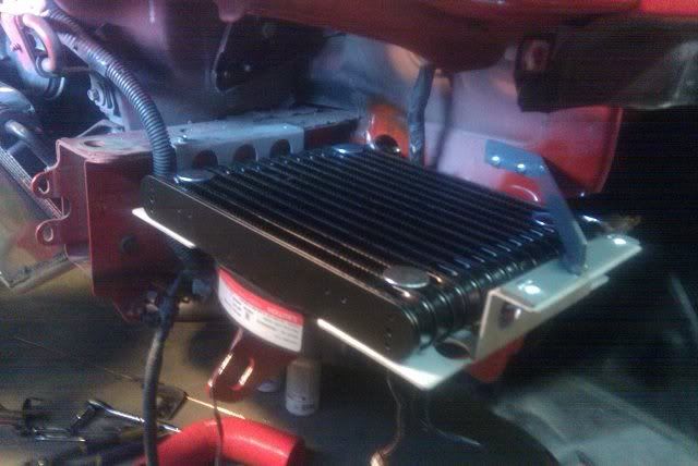

I know this is like months after the fact, but, I've mounted mine under the driver headlight. See pics. You just have to route one of the lines through the metal in the fender...not really a big deal.
Mine is a B&M 10x10 with an eletric fan that comes one at 180F
