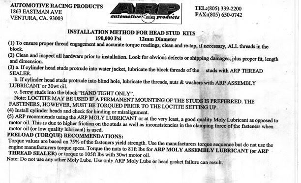

Where did you get that torq spec for ARP studs? It's wrong...don't post "I heard specs" again.
jdub
SM Expert
Feb 10, 2006
10,730
Valley of the Sun
here's what I based it on:
Your sheet shows a higher psi tensile strength (explains the higher torque) and no provision to use motor oil as lube. The version I posted was the last revision (2nd rev actually) I am aware of...when did you get yours? If it's recent, my apologies...most the time guys pull bolt/stud specs out of their arse. You obviously did not.
Keep something in mind though: The older (lower tensile strength) studs are still floating around...90 ft/lbs is an over torque for that version.
The bottom line is use the torque spec on the sheet that comes with the studs/bolts.

Wow, the versions of ARP stud instruction sheets are varied. I saved this one, I thought from jdub, that states 81 ft/lb.
Guess the best advice is use the one that comes with your studs, but buying second hand could be WAG.
Yep...the one I posted was Rev 2...the sheet PureDrifter posted is news to me.
i bought mine from 935 like 2ish weeks ago, so i'm planning on just using whatever's on the sheet.
