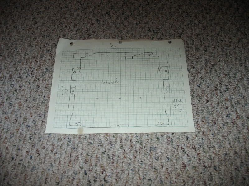

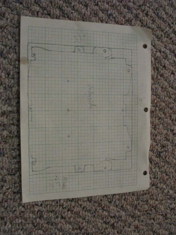

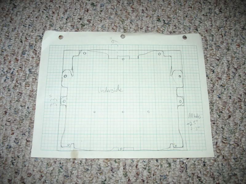

I bought an undercover brand new a couple years ago. Before installing it, I mapped out the cover on some engineering paper. It's to scale, and should be accurate to within an inch everywhere. It's only 2-D though, so it doesn't have the depth change noted except that most the holes were recessed into the cover by about 2-3".

supra: Awesome, pictures saved! Good reference material, thank you!
