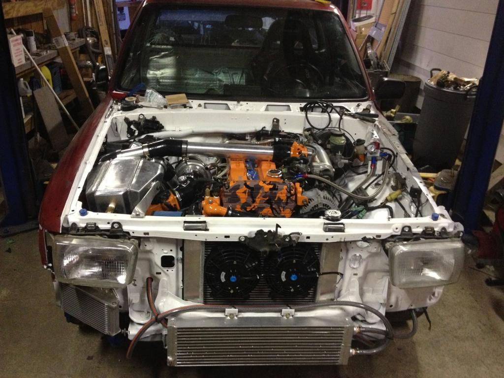

like i said you have to modify the firewall and trans tunnel to leave the body stock height or do the body lift and save all the headach plus the radiator is easier along with other stuff i can't think of this second lol. with the 1.5" body lift like i did you dont have to extend anything. the filler neck is stretched a little but its fine. heres a pic of my buddys

Thanks for the advice. Here on island we don't really have a lot of things like you guys in the states it's either order it online or have it fabricated. Lol. Ii guess I'll just cut the firewall it's just freaking me out cause the ac system behind it and I don't want to damage anything. So I'll pull the whole dash and ac out and cut it up. I think me and your buddy have the same front end. 1995 4runner. Pretty sweet truck can't wait for mine to finish. How does the air/ water intercooler hold up? Is it better then the regular intercooler? I was thinking of doing it but here on island it gets hot as hell.

what engine mounts and mount brackets are you using? cause with the combination of the 22re stock rubber mounts plus the mk2 supra engine mount brackets the firewall shouldn't need to be cut. just hammered out. and its mainly by the bell housing. we actually drilled holes in the cab to get the top bell housing bolts in cause it was near impossible without. then the big issue is the trans hits the trans tunnel and you cant make the angel of the trans steeper or else the back the head wants to hit the firewall and the hood clearance could become an issue. then the problem after you get the trans in and engine in at a good spot if you have lowering blocks on the axle when you accelerate or put a load in the truck the drive line rubs on the cab!!!! so you have to notch the cab out. its a huge pita compared to mine i just dropped it in and didnt have to do anything to the cab. and its easy to work on cause all the space behind the head and bell housing. and non of our trucks have ac but i bet the body lift would make that easier too. making it a low street truck is much more difficult.
and yeah he as the 95 4runner front end looks good. the air/water intercooler has worked well and mainly the lack of space for a front mount and the 10 miles of intercooler piping it would take made it a much better option. and has better response cause the small amount of piping.
