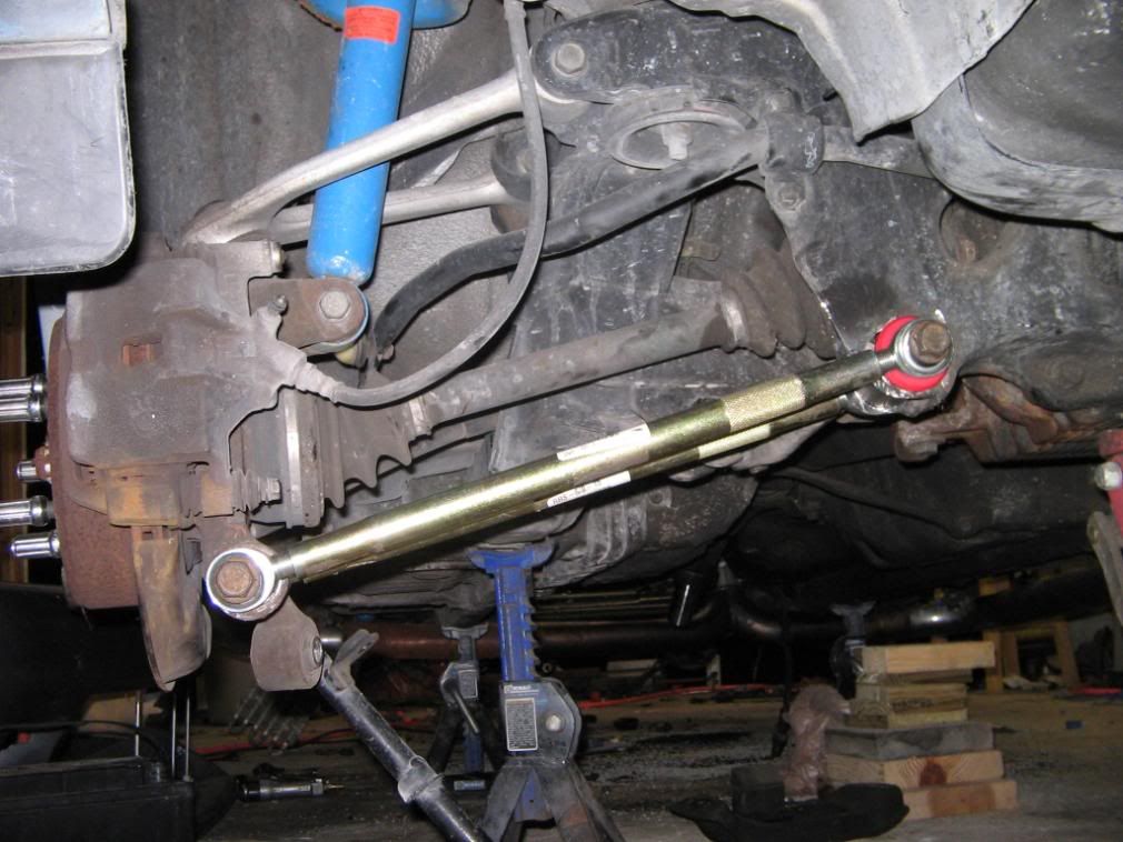

does anyone have anymore up close pics of the A1 products? in particular the toe arms? it seems like those could be made pretty easily. I might want to give that a shot sometime soon, but i'd want to pick the same parts as A1 in terms of dimensions.
and i always thought hiem joints were really good, why is there all the hate towards them?

jizake1jz;1269940 said:
any chance on getting the length on the steel sleeve? i'm at school but i want to order parts now lol
I will not be under the car again for a week or two. I would wait and see what IJ thinks of those before ordering them, I think he may say that's its to thin wall for this component.
