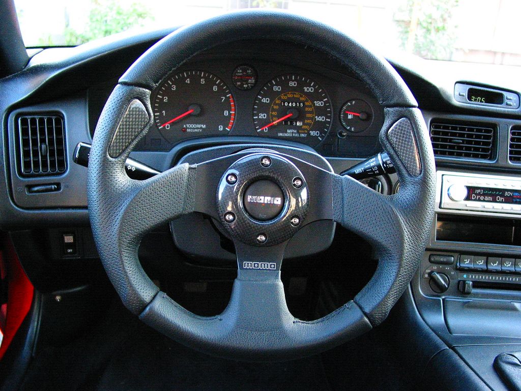

I have A spearco flash 5 mounted to the NRG V2 quick release on a momo adpater.
With the combo deal of the NRG & the momo it sticks the steering wheel out further and closer to the driver I plan to keep the horn ring installed and just use the two red buttons for the horn, lol I dont need them for NOS after all I am not paul walker.
