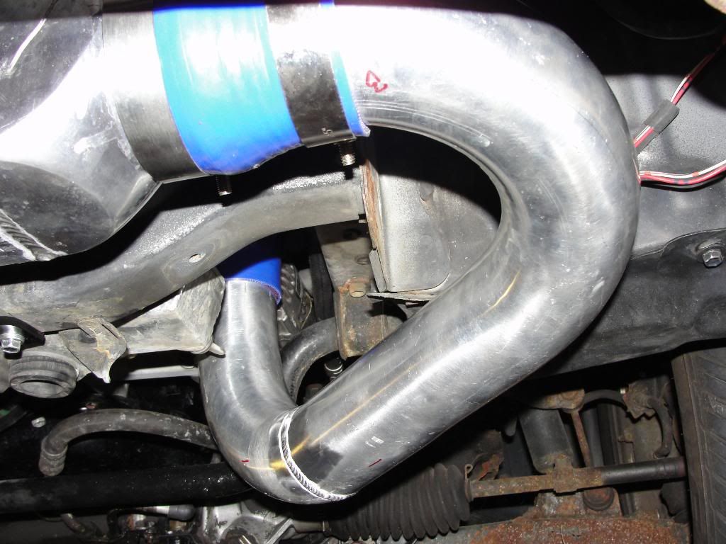

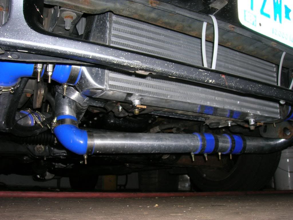

Canukrz- Myself, I went with this style because I knew I was going FFIM soon, but I also figured the IC had longer cooling tracks (read, flows L to R, not Top to bottom) so when I pushed the stock turbo it could keep up with the heat. It should also deal well with the larger turbo I was aiming to go with too.
^^I pretty much had the same idea...future FFIM, and bigger turbo. Plus I just dont like the look of the spearco styling IC. Even with this IC here no cutting, or modifying other than the oil cooler. Stock bumper and support go right back on and fits like a glove!
