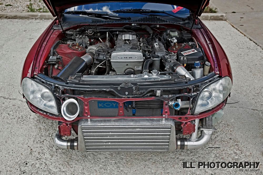

A local guy running a 7M AFM on his 2J NA-T. Not sure how it works. If you can't see it, it's on the cold side charge piping.

vry much posible. lot of mkiv guys here do it. as long as the meter is pre TB and manifold than it would be ok. as far as kv signal accuracy to the ecu i cant be too sure.
not too sue about how that BOV is placed though. seems like its far too far out of place to be working properly

Well I understand the MKIV guys, they have map sensors. This guy is using a 7M karman vortex AFM.

Can/Has it been? Yes, but i wouldn't recommend it. The MK3 Karman Vortex AFM can only measure volume or CFM. The placement of it should be before the turbo as before the turbo the only variables to the air are temperature other then barometric pressure with altitude. After the turbo the air can be pressurized greatly changing its density and changing the required fuel per cubic foot of air mass.
MAF sensors such as "hot wire" sensors can go after the turbo because they measure MASS AIR FLOW usually in grams per second. This measurement is more accurate then the karman vortex signal and will account for boost. The higher density air will absorb more heat from the wire then less dense air.
The MK3 AFM does not actually measure air flow, It measures air speed and air temperature separately, and reports those two signals to the TCCS. The TCCS uses those two signals with other data to calculate how much fuel to inject. Because there is no pressure or density factor in the calculation the TCCS would not "see" the added oxygen content from pressurizing (increased density) the air.

The 2JZ-GE used the same airflow meter for some time. The 7MGTE, 1UZFE and 2JZGE all used the KV.
