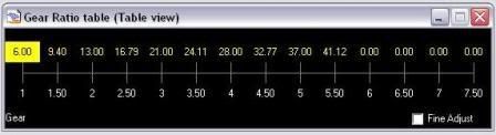

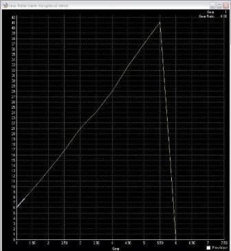

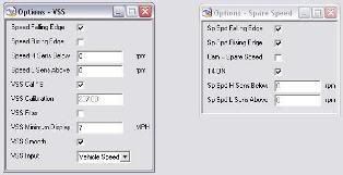

I want to share my current Vehicle speed sensor settings and gear display settings. They work ok, the speed display on a laptop matches the speedometer pretty close, and it displays the correct gear for the most part, but I think there's room for improvement. So if anyone has a setting they feel is better, it would be nice if they could share it. My car is a 90 Supra with stock LSD differential and R154. Dont forget to select your car in the vehicle sensor wizard
