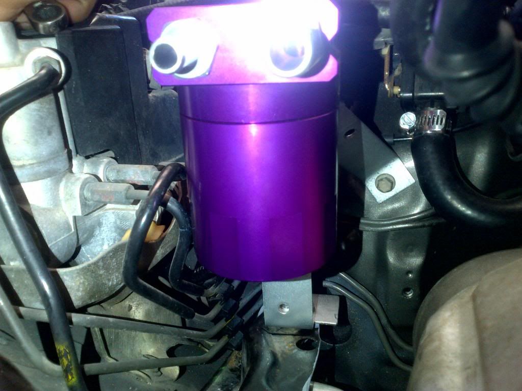

Looks good. The way I was going to hook it up was hook up the 2 valve cover ports to a T fitting then to in port on the can and put the baffle side to the intake turbo side.

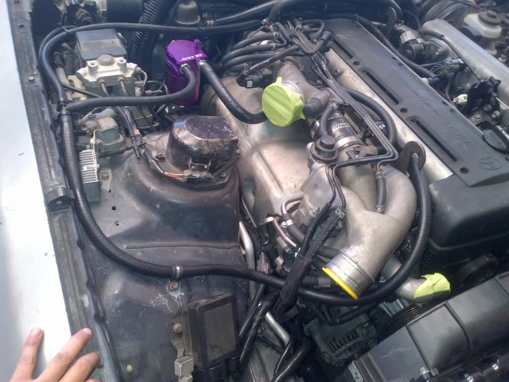

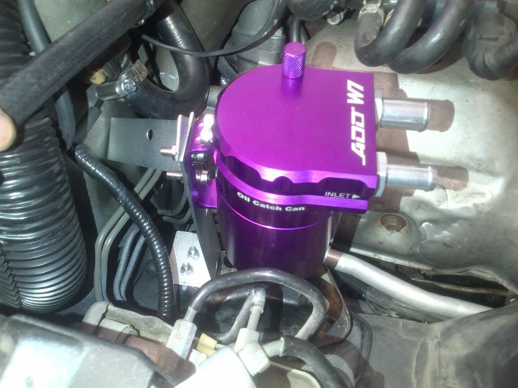

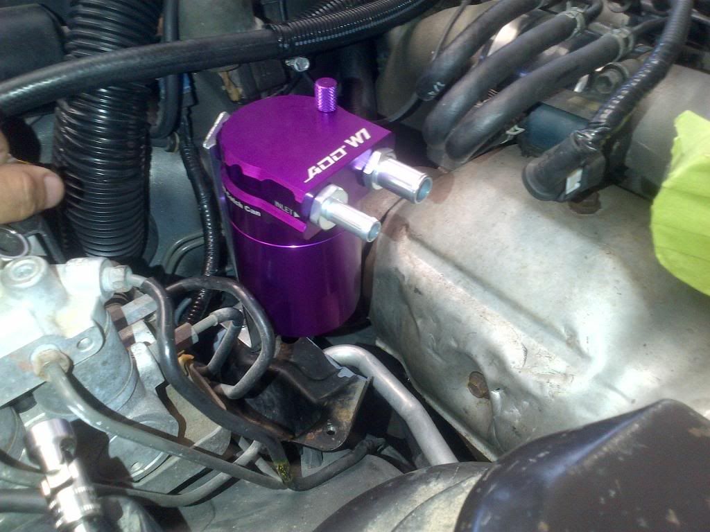

Here is my setup for the add w1. I was thinking of running it by where the washer fluid fill is but im having my intercooler pipe welded still and intake pipe from DM is coming in so I didn't know if I would have space, plus I could figure out a clean way to route the intake port to the catch can that way. I also put a foam filter inside the baffling case to help the condensation hopefully.

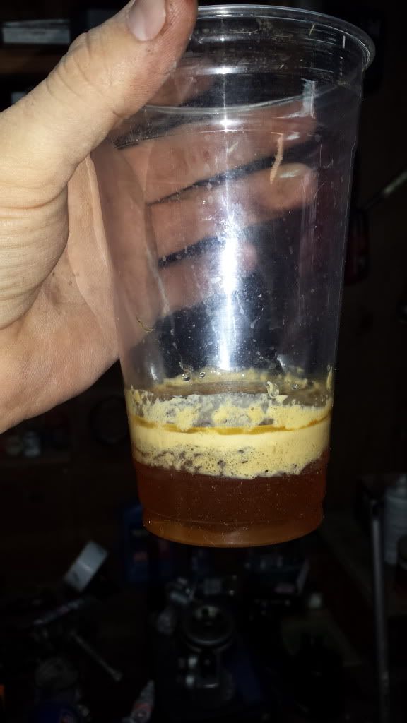

It works pretty good I'll shoot a pic of my collection from the week. But i have no control to compare it too.
I do feel like it can benefit from some stainless mesh in it also

Here is the collection from the week
That 4 trips to work and back 3 miles round trip
A 6 hour road trip all hwy and a 3 hour all hwy road trip
Seems to do well for the water I for sure think it will do better with some mesh in it

looks like some very nasty beer, but more condensation than anything. I thought steel mesh would just help with the condensation of the oil vapors not help with the water condensation?

I was thinking the mesh will help with oil separation out of the air
