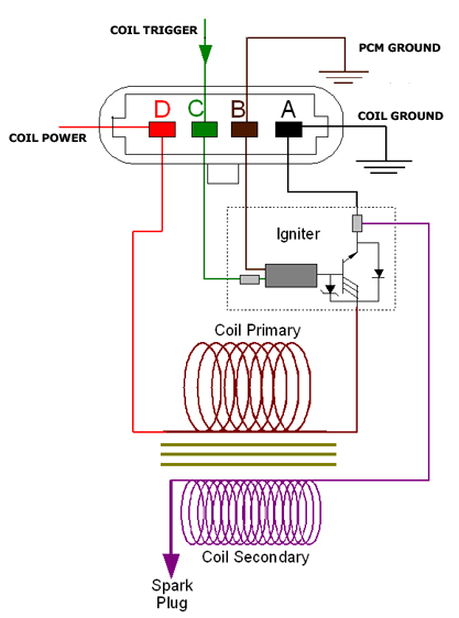

toyotanos
What will we break today?
Nov 29, 2008
2,844
Coon Rapids, MN
I have a suspicion.
You say the 4 wires to the coils are Power, ground, tach, and 'signal'? While this is true, the names are not correct; which may have caused the problem indirectly. I think you may have wired your coils incorrectly. There are 2 different ecu pins on the coils- IGT and IGF. The AEM doesn't need IGF, so they're usually left disconnected. IGT, however, is the main show. If you hooked the trigger wire from the ECU to IGF, you wouldn't have any way to fire the coils.
[strike]Looking at the pins on the coil, the left most pin is your power input, the second to the left is IGT, third is IGF, and the right hand pin is the ground. Double check to make sure your harness is wired up like this![/strike]
This diagram shows the connector view: http://www.mazdamaniac.com/images/rx8/electronics/ls2/ls2_coil_schematic.jpg
mikejza70
Nov 3, 2012
65
mn
toyotanos;1942136 said:
I have a suspicion.
This diagram should help: http://www.mazdamaniac.com/images/rx8/electronics/ls2/ls2_coil_schematic.jpg
That might be possibility. That pinout is different than the pinout I used ->
http://www.sergionicolau.com/viatur...ignicao - cop - parts - toyota cop pinout.jpg
Which one is correct? I'm willing to try the pinout you showed me
