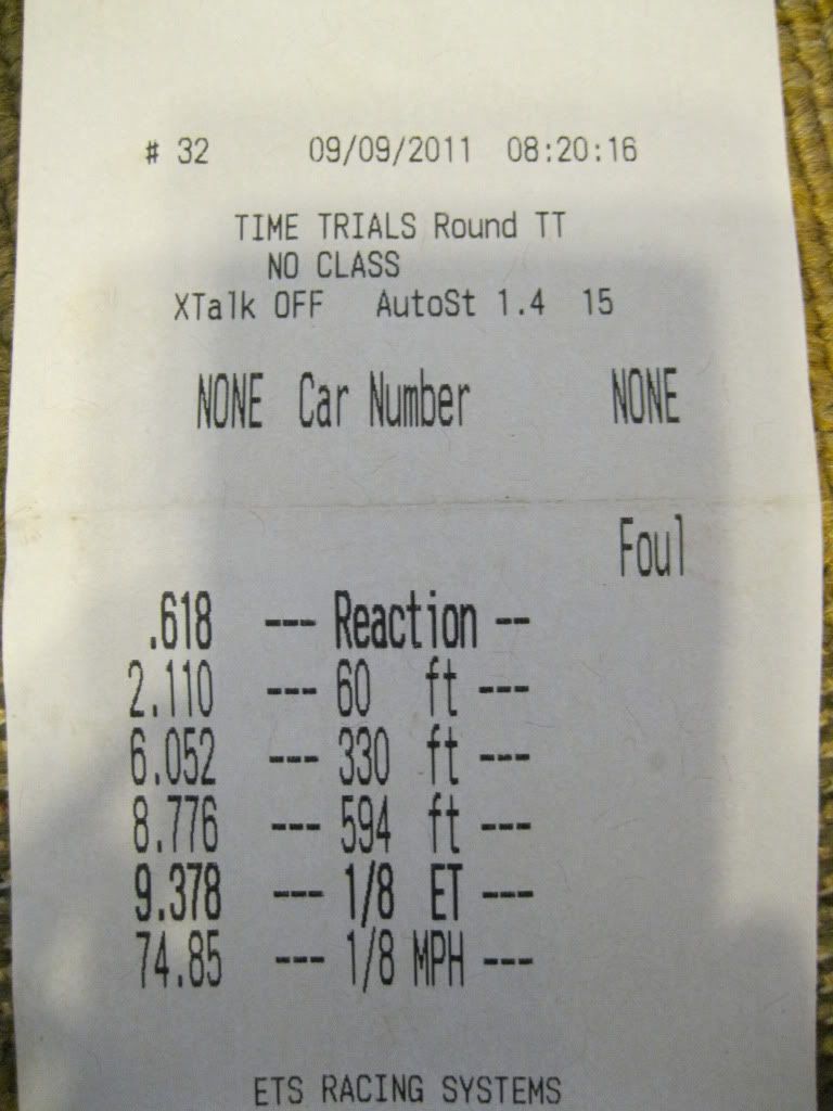

9.3 @74 in the 1/8th
ricerkid
Jul 8, 2009
57
St. Louis
Car is non turbo. 10.6:1 compression and a megasquirt 2. I think there's more in it but i guess i'll see next time I go to the strip.
