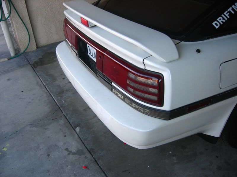

I just took the studs off (they slide out) no big deal really. And as far as the mouldings, I just used a blow-dryer to heat my pre-89 moulding, and peel it off...then I double-stick taped it to the 89+ moulding.
Here's a pic:

Ok I installed the 89 tails today the only change was i had to pull off the little moldings above the plastic moldings and it lined right up. The backs were rusted to hell so i just broke the bolts and it was a direct line up.
Johnathan... When you put your moldings on there was there a gap between? I can't tell from you pic.

alright i just lined it up. Did you just tape it onto the plastic molding looking piece that was there? Does it come out real far and look a little awkward from the side? Thanks

I think that looks good. I popped them little moldings off above the trim and painted them white so it matched better. I'll get a pic if you wanna see it.
