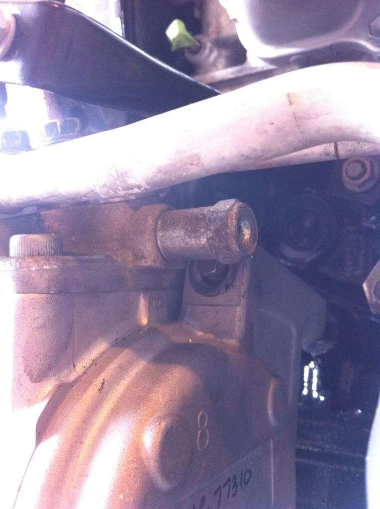

Have a look at this pic... the stud on the engine sticks out so far that the piece on the A/C pump hits. Do i need to cut down the stud in order for the A/C pump to slide all the way on?

Do you have a spare compressor head for a 7M?
I know Tissimo had this issue years ago and ran only two bolts and moved that stud down below.

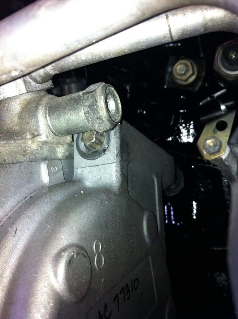

I was over at a local guy who did a 2JZ swap and looked at the A/C. I told him to do what is in the JZ thread, which he did.
It seems that there is a variation in the compressor head of the 7M as his 7M compressor head doesnt have the nipple interfering like yours do. It's not even on there. His was out of an 89 but we can't trust that as these cars are so old so I will look into it more for you.

Looked it up, there is two different heads but I can't seem to find a good parts picture to know. I will check a customer original 91 and see how the 7M compressor head is.
