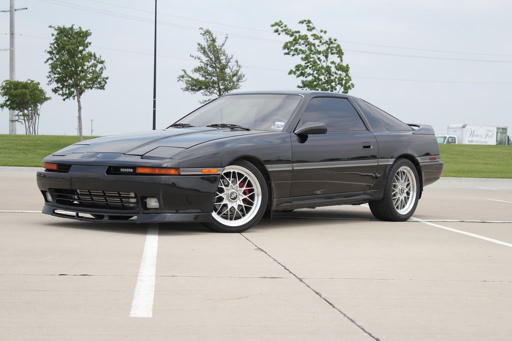

My brother got his car on the dyno a few weeks ago. The car made 713 on race gas at 23lb's through a billet 6766. Tuned with an AEM by Chris Hamilton (Hamsmkiv). :)

BC 272 cams
Ferrea springs
JE pistons polydyne coated
Eagle rods
Shimmed oil pump
2J intake manifold with custom lower runners
Bosch 044 pump
660cc injectors
Power was limited by the fuel system

wow sergio's car has come a long way since the bpu 7m with ct26! bet its a monster now! hows the top end on the setup? he needs to run some jz cars and see how it does :)
