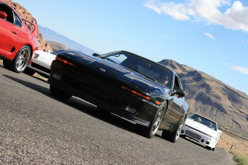

So Aaron what size rubber you have one the black supra? 275 or 315? and 5zigens are FTW in any size.

Mine are Falken RT-615 in 275/40/17 on 10" +35 wheels in the rear, and Falken RT-215 (now discontinued, replaced by the RT-615) 245/45/17 on 9" +35 front. The rear never rubbed, but the front required rolling the fenders. If you ran 235/45/17 front it would not rub. I have run 18" wheels before, but I think 17" is the best all around for handling and grip. The 18" wheels do look cool, but I think 17" perform better. The first two pics I posted above were when I was running Nitto drag radials on the back, and the pic on the bottom was recently taken in Vegas.
