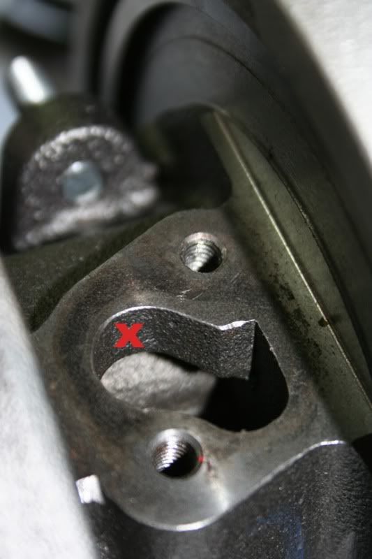

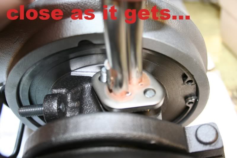

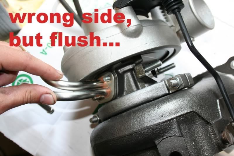

hey all,
earlier this summer i had my turbo rebuilt as a 57 trim by driftmotion. when i got it back, i noticed that my coolant hardlines wouldnt sit flush against the housing. the nipple that enters the turbo housing was hitting the inside of the housing at a very obtuse angle. in order to install the piece, i used a wood block to knock the lines into place so that i could mount them up flush.
once installed, my bearings deteriorated to the point at which my impeller wheel was scraping the housing in about 150 miles, or 2 weeks of driving. i took the turbo off, sent it back to driftmotion, and they told me the turbo wasnt getting any oil because they couldnt see any evidence that the turbo was shitting oil. i checked my oil lines, and they contained oil, and i checked my banjo bolts, which also contained oil, and didnt see any sign of blockage in any of the parts i inspected. my only guess was that there was a blockage in the oil passages in the turbo itself. i prepped the turbo with oil per the tsrm, and cold cranked it before i started it until i got 20psi of oil pressure per the stock gauge. oil pressure was normal the whole time i ran the turbo.
driftmotion rebuilt the turbo again and sent it back. i still dont really know why my turbo died, but upon trying to reinstall my coolant hardlines, i got the same issue- they wont sit flush against the gasket surface, as pictured here:

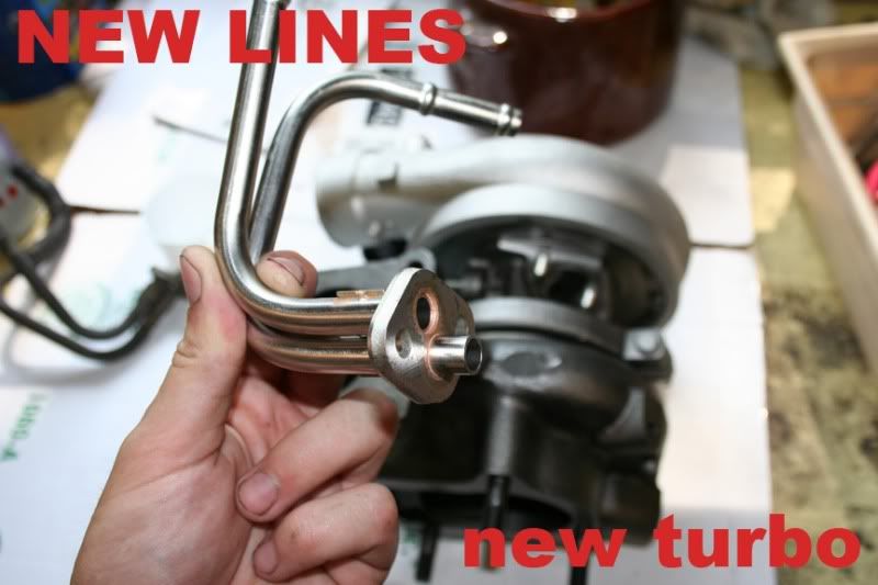

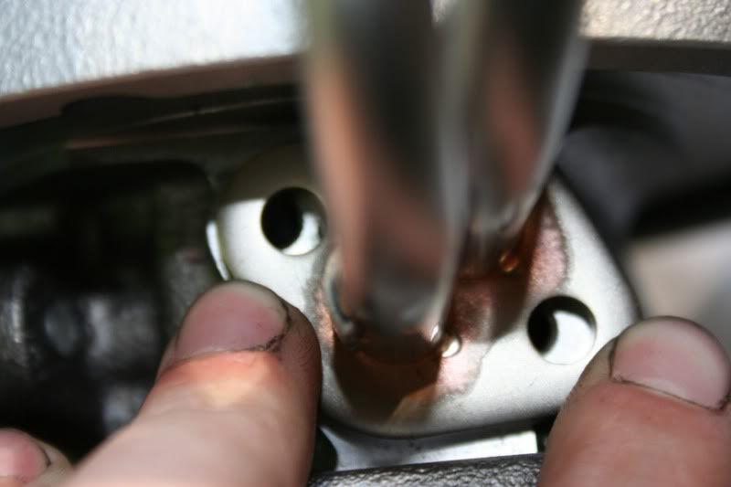

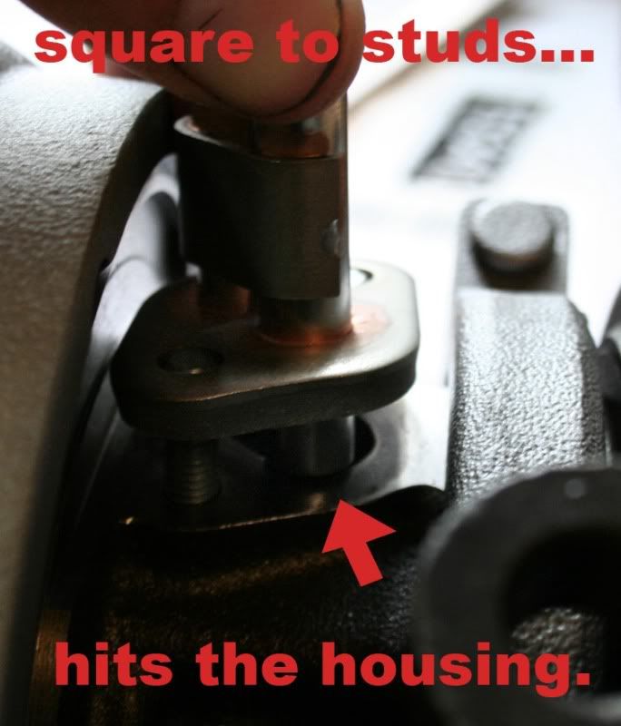

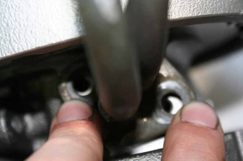

the weirdest thing about this issue is that when i put the hardlines on the other side of the turbo where the blockoff plate is supposed to be installed, it sits perfectly flush:
when i forced the lines onto the turbo initially, i ended up bending the nipple in a little bit, so i tried to straighten it back out in a vice:
i think it would work, but it ended up cracking the metal, so i ordered a NEW set of lines from toyota today for good measure..

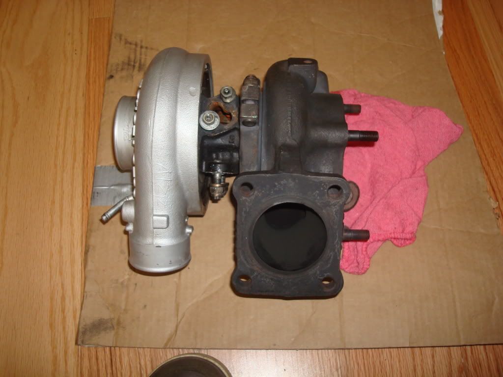

the reason this concerns me so much is that before i ever sent my turbo off, or when i removed the lines from my original stock turbo, they mounted up fine, and i never had any trouble out of the turbo in that form. when i ran the rebuilt turbo, it appeared to be very hot, as it was steaming after i drove it hard.. i wrote it off as gasket material among other things burning off, since it was new.:3d_frown:
i reckon my turbo was getting really hot.. TOO hot. as far as i know it was getting oil the whole time. is it possible that my turbo was running so hot that the oil inside of it was evaporating, leading to bearing failure? as a result of the coolant nipple being slightly deformed? i never blew any black blue or white smoke when i drove it.
is it possible that my turbo is clocked wrong or that it has been reassembled incorrectly so that the lines will not fit? is it just a matter of the mounting studs being off center? do you think this is the issue that killed my turbo, or should i continue to look for an oiling issue? how do i get these lines to mount up flush anyway?
i do not want to kill another turbo. im running out of time here before fall semester starts, and when i assemble the turbo system this time, i want it to stay that way.
ANY INPUT IS GREATLY APPRECIATED!

if the oil line and drain are on the bottom... it cant be clocked wrong... id say you prob got a diferant turbo... or are doing something wrong yourself... but as long as the oil lines are on bottom... it cant be clocked wrong

Wow. Never read so much BS in my life. A ct is a ct is a ct. Hitachi built hundreds of thousands of ct based turbochargers. They are all the same.
When you send in a core to a turbo rebuild company, 90% of the time you get another persons "turbo" back. Its not a big deal. Happens every day.

The ct26 is pinned - both compressor housing and turbine housing.
You really can't get the housings clocked off, unless you forget the pins. I'll stand behind Aaron and Driftmotion to say I highly doubt they forgot the alignment pins.
boostin300 said:
EDit #2 lol - could be very possible your turbo is clocked 180deg off:hsugh: hahaha ... sorry but if that sits flush on that other port..mount it on your manifold and see if that's the case. dude if it is and you can prove they clocked it upsidedown before they sent it back you better get them to pay for a new one. I'd be pissed like none other, a mistake like that can cost you a motor.
Good luck man.
Seriously. Is some one playing a joke on me? Ian? Mike? Can I get some help here?
That ct26 pictured is not 180 rotated.

Have your new lines arrived yet?
*edit* Jon beat me to it - I have a feeling we're looking at a slightly crushed flange that's been overtightened, followed by running hot (as coolant will seep out) thereby warping the flange.
Brand new lines will confirm / deny that theory ;)

that is the wrong coolant inlet!!! there is one on the opposite side. how did you and more importantly DM not notice that the hardlines are in a completely different location from stock. :aigo:
i'm no turbo expert but i bet if the turbo got extremely hot it would instantly cook the oil so that could be the reason it failed.

MDC, thank you for the clear and concise response! my new water lines are gonna be in on monday or tuesday.. toyota said they had to source them from louisiana. i ordered every gasket in the turbo system from toyota parts dept. when i reinstall the turbo, i will torque every bolt to spec. Aaron from DM had suggested trying the method of testing for oil flow you mentioned above, and i will be sure to do that before bolting everything up again. thanks again.
as far as the flange being warped from heat and not fitting, even though it has now been deformed, i dont think that's the issue because they wouldnt properly fit the rebuilt turbo initially, before they saw more intense heat levels.. but as you said the new lines will tell when they arrive.
once again thanks for the responses, and if anyone else wants to chime in i would greatly appreciate it! till then, i guess im gonna have to wait till next week to see what the deal is.

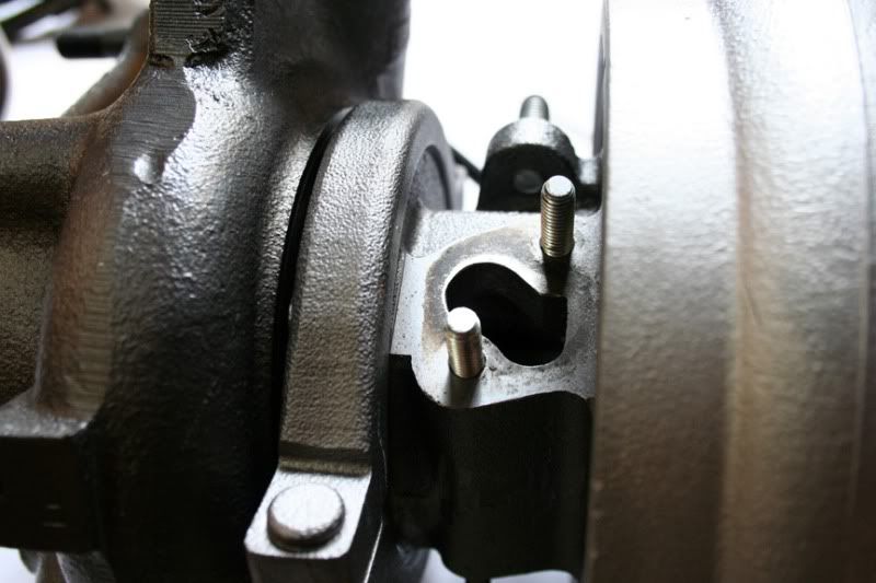

OMG!!!
look at your turbo....there is a block off plate on the OPPOSITE side that is originally where the coolant enters and exits the turbo. WTF. how do you not see on the pic with my turbo the inlet is on the side that the exhaust enters!?!
i don't understand how you even got the original coolent lines to work the first time with them on the opposite side. also the block off plate is where you mount the dipstick to the turbo. how this is confusing i don't really know.
look at the pic in the tsrm. see how there is a plate right there....that is where its suppose to be. your turbo has that open and the plate on the other side. now do you see? :aigo:
http://www.cygnusx1.net/Supra/Library/TSRM/MK3/manual.aspx?S=TC&P=9
and rotating the center section of the turbo will make it so your drain isn't facing down.
new hardlines will be nice but they aren't going to fix this problem....
cliffs: you need to put the block off plate on the side that you have been trying to install your hardlines. the center section is made to work on different motors so they have two coolant inlets. one of which has to be blocked off...

lol read what i wrote man.. there IS no blockoff plate installed right now. it is in a little baggy. the hardlines are mocked up on BOTH sides of my turbo in the pictures. they are NOT mounting up where they ARE supposed to. the OTHER pictures with the lines mounting FLUSH are on the WRONG side of the turbo, where the blockoff is SUPPOSED to be installed. im not actually trying to mount them there, and for the love of god i didnt have them installed that way when i ran my turbo hahaha.. the soft lines wouldnt connect to them and youd think i would notice. no man im not that dumb. the issue is sadly more complex and troublesome..
i was wondering what you were talking about..

sighh... got my lines early today.
they dont fucking fit. here they are, square to the studs, chillin. the damn water nipple WONT EVEN ENTER THE HOUSING.
heres my water port..
and this is as far as i can get the lines on the studs and into the turbo without hitting or forcing anything..
and of course...
i cant get a square in there to see if the studs were put in straight or not. thats the only thing i can think of right now.. they dont look THAT out of whack even if they arent square to the housing. theyd have to look really cockeyed to warrant how far off the water nipple is from the edge of the port.
WHAT THE FUCK GUYS?!:madfawk::madfawk::madfawk::madfawk::madfawk:

I'm telling you man, you got the wrong turbo back or it's clocked 180 off, like I said earlier. Flame me but what else could it be?
zambini
Jan 16, 2008
464
Detroit, MI
well well...:nono:
i took the studs out to see if they were bent or what. it dawned on me that the line fitment was SO FAR OFF that it COULDNT be the studs... so i put the damn hardlines ON the flat, studless gasket surface so that the nipple ACTUALLY CLEARED the housing and took a picture:
THESE ARE THE NEW LINES
THESE ARE THE OLD LINES
THE LINES ARE BEING PUSHED AS FAR AS THEY CAN GO in the direction of the stud holes. THIS TURBO ASSEMBLY IS NOT CORRECT in one way or the other... either the studs are in the wrong place, or the inside of the housing cuts in at too much of an angle. something here is WRONG and its not something i can fix.
here is a closeup of the port and the place where the lines are hitting:
WHAT EXACTLY IS WRONG???
