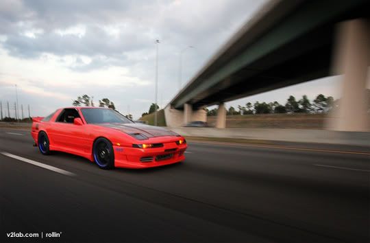

Nice numbers!
I do have a complaint though. Nothing you ever post should ever be without a picture of YOUR car at least.
Here you go-this was on the way home from the dyno:

Love the pic and love the numbers!
