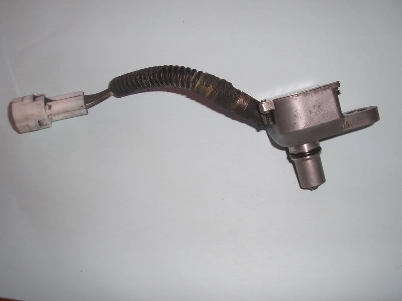

This is the rear speed sensor from the A340E...
It is not the same as the one from a R154....

They're different.
The sensors are magnetic type sensors. The Auto has an extra pin, that my hunch tells me has to do with OD. You should be able to use the Auto. I didn't even bother.
I posted a WTB ad and got one.
I'm in no mood to pull the Auto Sensor off. But i can get you pics of the R154 sensor if you want. :)
