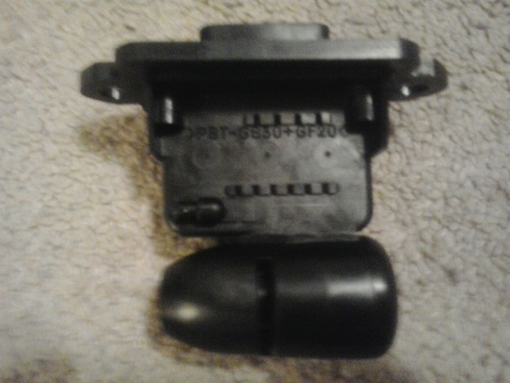

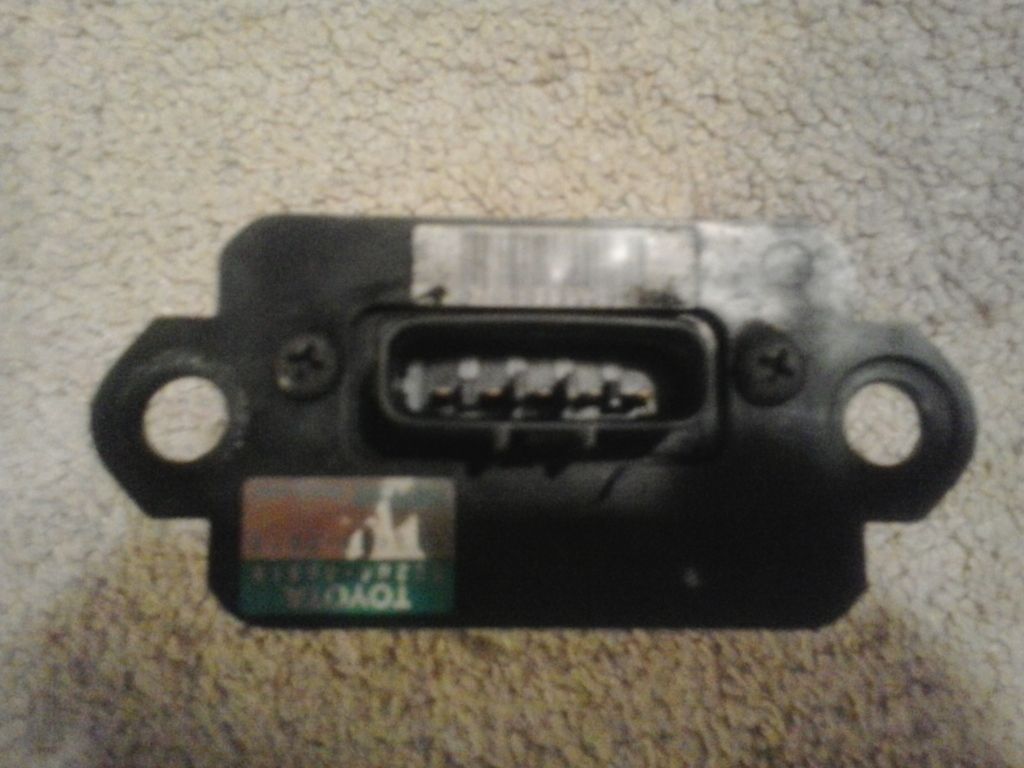

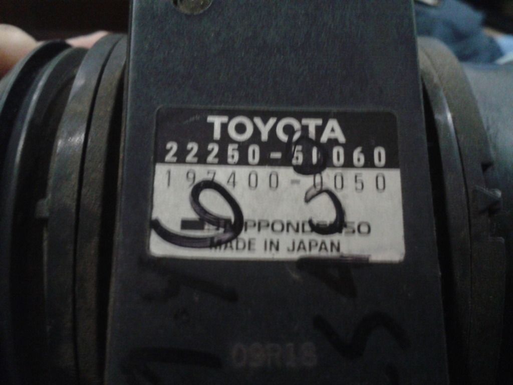

Ii have a 2jz maf on my bech at home I will post a pic of it as soon as I get home so you can ck the part number . Maybe work something out to get it to you
525gte
Sep 19, 2011
450
hoquiam
Pretty sure this is for a 2j. If this is the one you need pm me

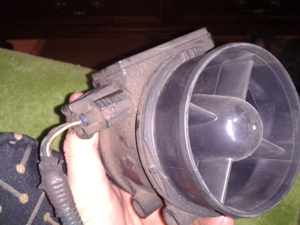

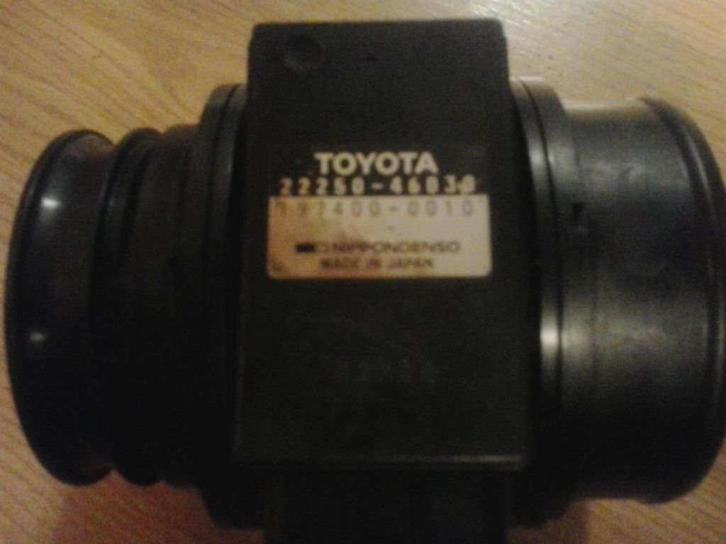

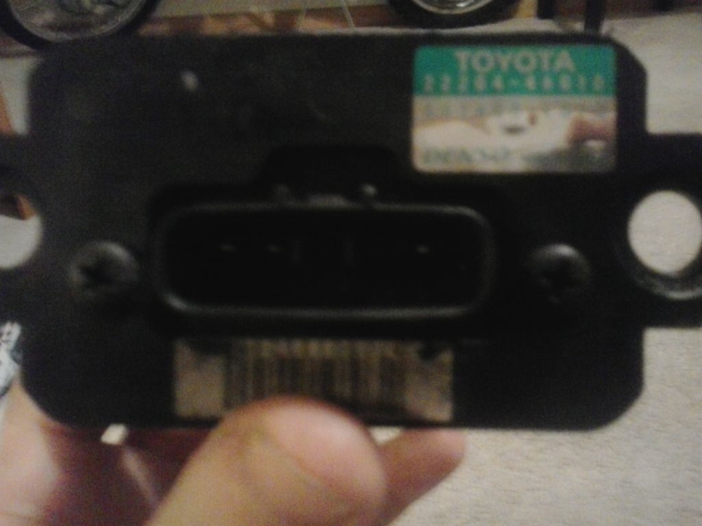

I have both stilles of maf's I have a 98 Supra TT maf and a aristo 2jz vvti maf.
I just don't have the housing for the aristo maf and the supra maf makes the engine too rich.
Supra maf #: 22250-46030
197400-0010
Aristo maf #: 22204-46010
197400-1010
Here is my supra maf that I have.
Here is the aristo one

The USDM Supra TT MAF (non vvti) is not compatible with the 2JZ-GTE VVT-i motor or ECU out of the box (I have personally tried it)
The housing ... if you can't find one from a GS300 (98+) or a 98 n/a Supra, most any after market one should work as a housing pipe.
Also the 22204-22010 MAF (from the 2JZ-GE VVT-i n/a motor that looks just like the 46010 part that will fit in the stock pipe) is compatible with the 2JZ-GTE VVT-i motor and ECU.
I've been using a MAF from a 1999 GS300 on my 2JZ-GTE VVT-i swap now for over 3 years and 20k miles on stock turbos and ECU with no issues.
