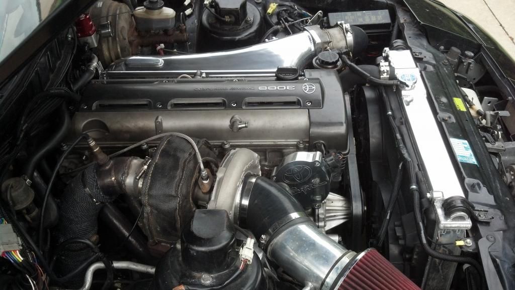

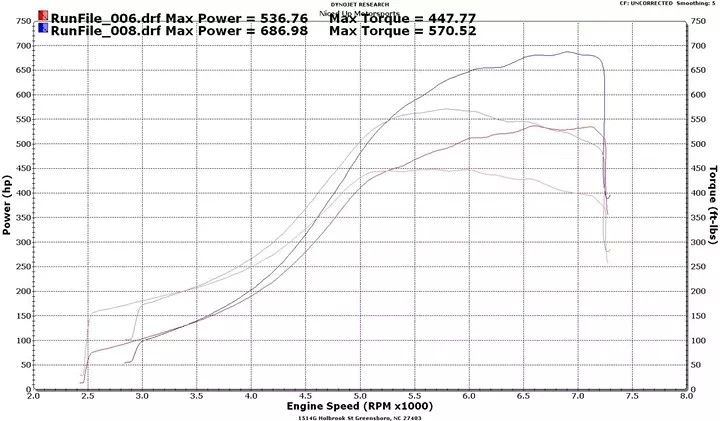

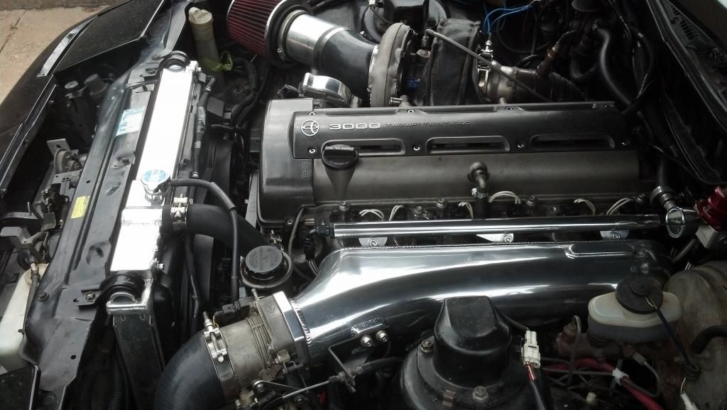

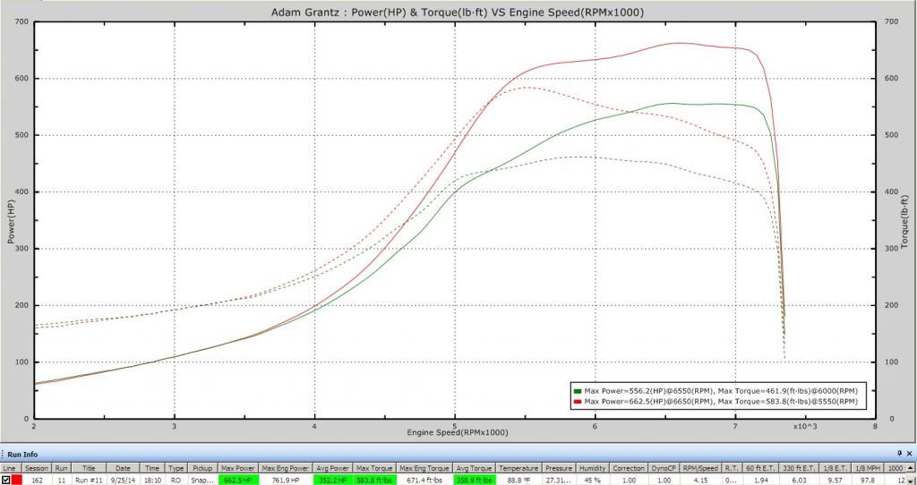

2jzge dyno results 660whp @20psi
1986.5supra_kid
Rice? No its Corn (E85)
another 2jzge :)
id1000
aem v2
s366
lq9 coils
TT HG
ARP Studs
r154 MC and DM parts
ACT extreme PP and 6 puck
3in steel one piece 3.91
Flexfuel sensor
20psi on e85
16psi on 93octane
has A/c and soon to have cruise control
this is a daily driver
The motor is from a 1992 sc300 and the motor has roughly 200k total miles on it now counting the rebuild 40k ago which was seal and bearings no machine work done.

What RPM do you hit full boost?
looking at the dyno grap it looks like 5000-5500rpm it hits real hard. im sorta in the same boat as suprakid where i maxed out my hx35 and want more but love the crazy bottom end power. seeing his graph makes me positive now that im going with the fmw s362. flows a lot more than the hx35 but hits hard a 4000rpm from what ive seen. the s366 is more of a hw and drag turbo. wouldn't be good for autox or small tracks. but the numbers are impressive for the boost levels no doubt!
