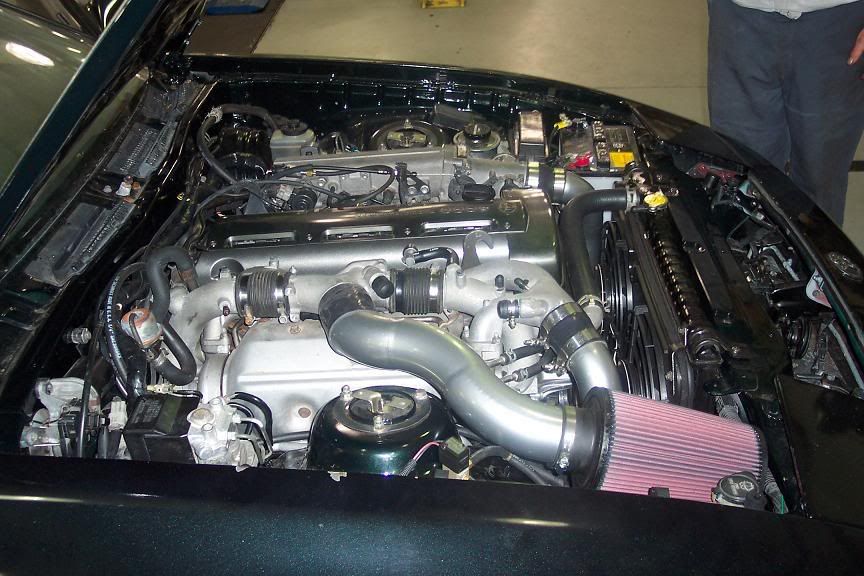

Yea, with the US twins, i had to grind a bit off the BOV pipe to clear. (dont remember if it was cause it hit or was really close. I built the car 2 years ago.)
http://i129.photobucket.com/albums/p227/tissimo91t/DGM%20Car/Buildup/2jzdone3.jpg you can barely see its ground down a little bit.
Had a look and it seems ifs fouling on the outlet for the BOV. cutting into the under of the bonnet reinforcing (about a 2" strip) should do the trick.

I used stock mkiii mounts and had an issue.
Like i said though its only the USDM twin BOV outlet (the jdm is mounted different).
Yea I didn't want to cut the hood brace so I ground down the bov peice. Though on hard launches it did rub on the hood, and messed up my paint :(

Take a piece of tape, place it sticky side up in places you THINK it'll hit. then lift the hood. It'll show you where the problem is. simple as that. Then you can figure out how
you anna solve it.
you anna solve it.
Jeff
Yeah thats what i did. well sprayed paint on the underneath of the bonnet on the lining. showed up on the BOV outlet :(
