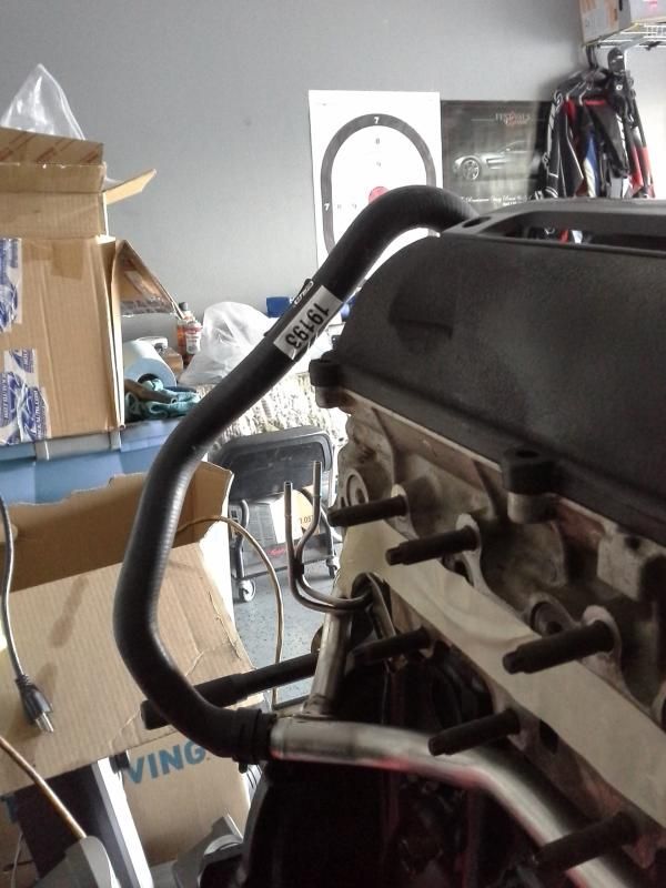

Just asking if anyone here have done a heater core bypass/delete on their mk3 with 2jz single platform. I don't want to cap off the water pipes so any guidance or pics will help.

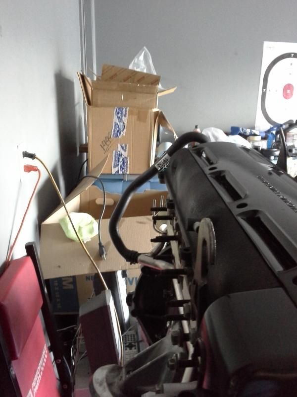

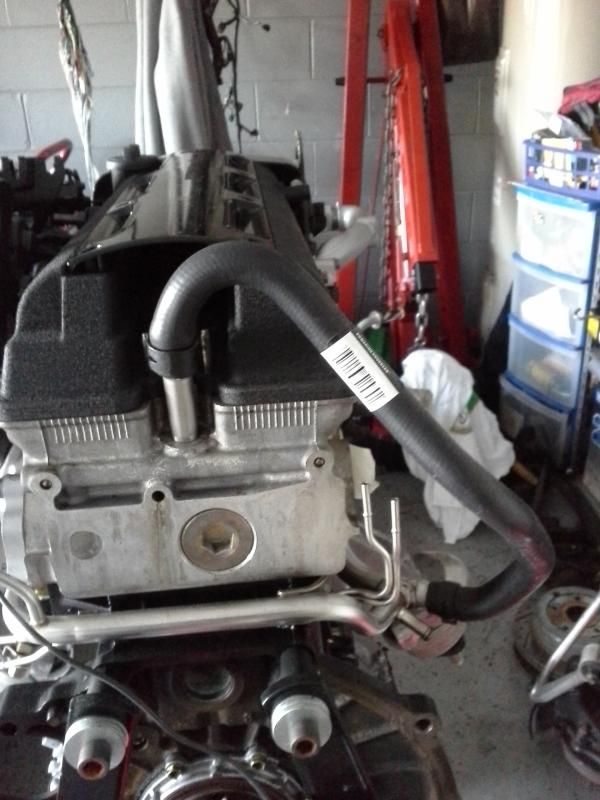

an update for the people looking into this, i found a molded hose at my local parts store that fits pretty good. you might be able to find something better if your store has alot of options. I used a Gates heater hose part# 19193.

I guess it works for what you want it to do but I think what S.A. is getting at is that it's unsightly. I can understand you not needing a heater in FL but is it really worth having your nice shiney 2J growing a napa hose out of the back of it's head? I'm not a fan but in the PNW no one in their right mind would be bypassing their heater cores...
So long as it's working for you, that's all that matters!

i really don't like the look of it but the other option it to cap it off which can probably cause issues with overheating.
i just have to see how it looks once installed in the supra.

Correct. Do not cap it off, It makes the engine harder to vent and affects the cooling inside the engine.
