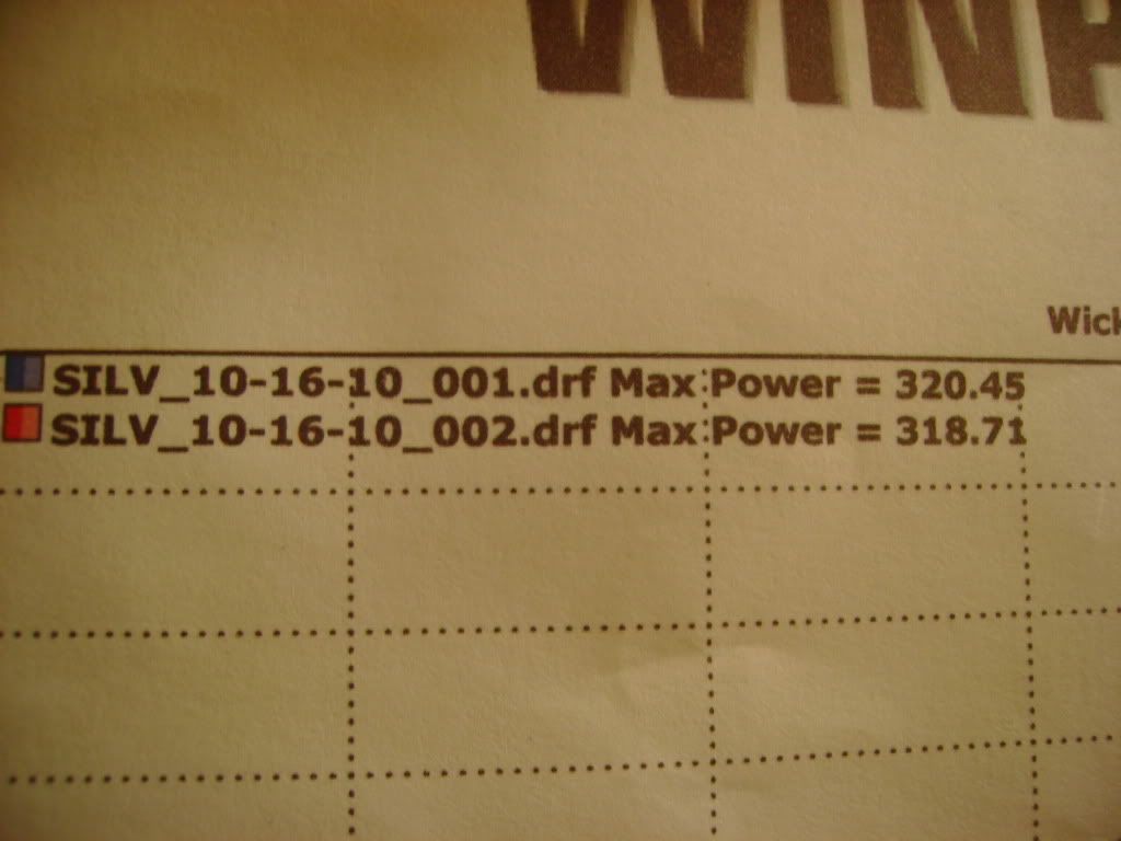

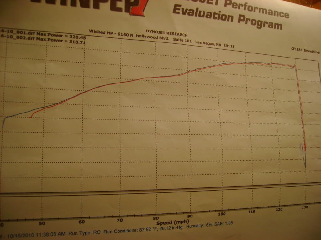

Very impressive. I run my car pretty regularly at 16-17psi on the stock 370cc injectors, afrs when my wideband is cooperating are usually mid 11's.
Beals;1931125 said:
...was thinkin about putting cams in but I heard they still drop off around 6000rpm, you should dyno your car for reference =p
False on that one buddy:
This was on stock everything except cams and head porting, and 3" exhaust. ~12psi, and only revved to ~6300 by the dyno operator for some reason. The cams aren't the restriction at this point, the tiny turbos, tiny manifolds, and tiny outlet piping are most suspect in that regard, at least to me. :)
